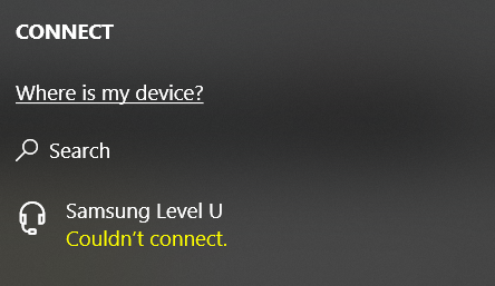

    • Notification center -> Connect displays Samsung Level U as Paired, but when attempting to Connect to it, it displays "Couldn't Connect".

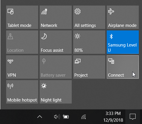

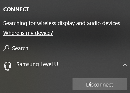

    • Power-cycling the headset changes its state to (presumably) connected, and the "Disconnect" button appears. But still: there are no audio devices available.

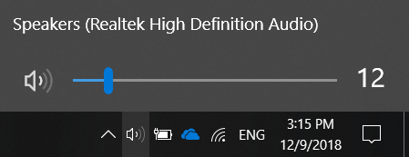

    • The device doesn't appear as an audio device:

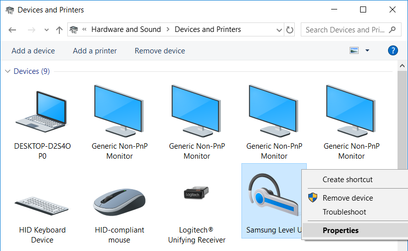

    The device doesn't appear as an audio device in spite of being connected, because its audio-related services are not enabled. Navigate in Explorer to Control Panel\Hardware and Sound\Devices and Printers, right-click on the headset device, and select "Properties":

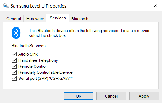

    In the device properties, the Bluetooth services related to audio are likely to be unchecked:
    Check all the services, and click "OK".

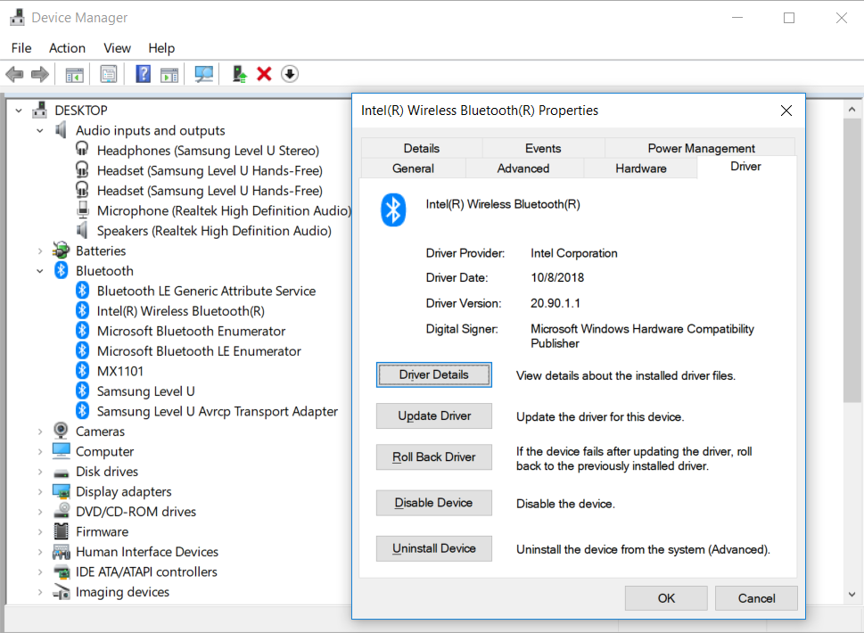

    The newest drivers for Intel(R) Wireless Bluetooth(R) must be downloaded and installed from [Intel's site]. I chose the newest driver at this time: version 20.90.

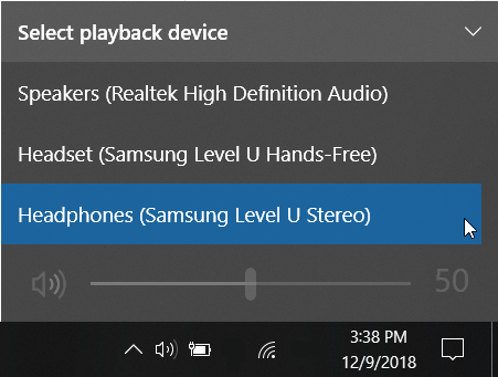

    After installing the driver, power cycle the headset, ensure that it shows connected in the notification center's "Connect" pane, and re-enable the services as described above. After clicking "OK" to re-enable the services, the headset will become available for use as an audio output.
