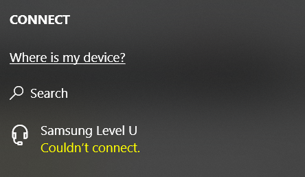

    This happens on an Asus ROG G551JW computer. I got a Samsung Level U headset. I can get it paired via Bluetooth, but it's not recognized as a sound device: it doesn't appear in sound device lists, I can't control its volume nor make the system output the sound via the headset.
    Relevant System Information:
    • Windows 10 Pro 64 bit
    • Intel Bluetooth Driver version 19: Intel(R) Wireless Bluetooth(R) driver version 19.x.x.x

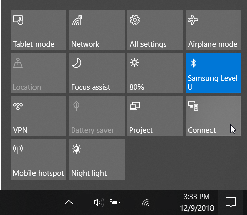

    • Notification center -> Connect displays Samsung Level U as Paired, but when attempting to Connect to it, it displays "Couldn't Connect".

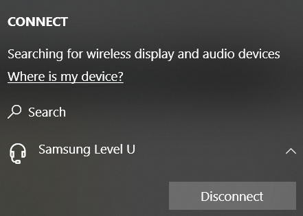

    • Power-cycling the headset changes its state to (presumably) connected, and the "Disconnect" button appears. But still: there are no audio devices available.

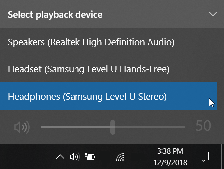

    • The device doesn't appear as an audio device:

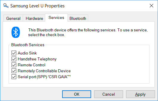

    Enable the needed Bluetooth Services on the Device

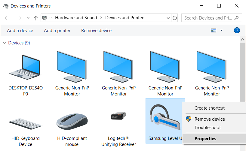

    The device doesn't appear as an audio device in spite of being connected, because its audio-related services are not enabled. Navigate in Explorer to Control Panel\Hardware and Sound\Devices and Printers, right-click on the headset device, and select "Properties":
    In the device properties, the Bluetooth services related to audio are likely to be unchecked:
    Check all the services, and click "OK".

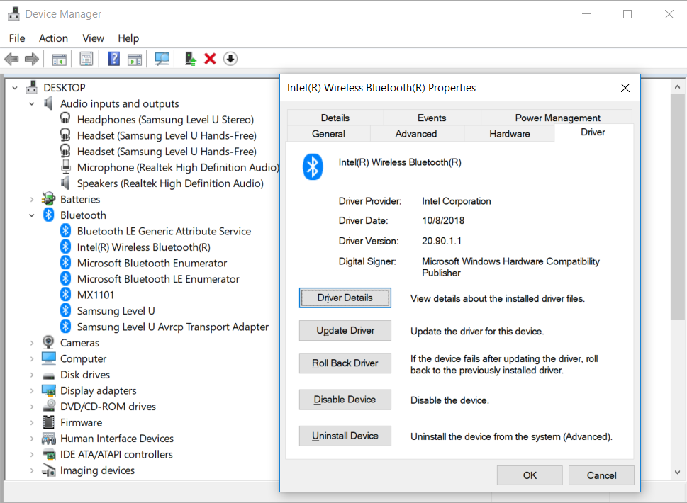

    If you get the error, the typical cause is an outdated Bluetooth radio hardware driver. As of 12/2018, the Intel driver version 19 is seemingly too old to reliably operate with the newest Windows Bluetooth stack.
    The newest drivers for Intel(R) Wireless Bluetooth(R) must be downloaded and installed from [Intel's site]. I chose the newest driver at this time: version 20.90.
    After installing the driver, power cycle the headset, ensure that it shows connected in the notification center's "Connect" pane, and re-enable the services as described above. After clicking "OK" to re-enable the services, the headset will become available for use as an audio output.
