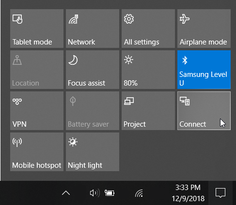

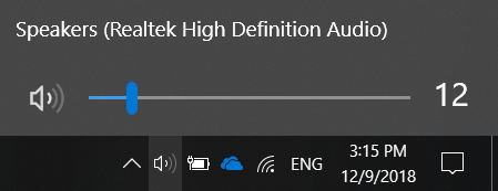

    How to get a paired, connected Bluetooth headset to be recognized as an audio device?
    This happens on an Asus ROG G551JW computer. I got a Samsung Level U headset. I can get it paired via Bluetooth, but it's not recognized as a sound device: it doesn't appear in sound device lists, I can't control its volume nor make the system output the sound via the headset.
    Relevant System Information:
    • Windows 10 Pro 64 bit
    • Intel Bluetooth Driver version 19: Intel(R) Wireless Bluetooth(R) driver version 19.x.x.x

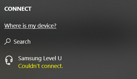

    • Notification center -> Connect displays Samsung Level U as Paired, but when attempting to Connect to it, it displays "Couldn't Connect".
      Bluetooth headset is connected but is not recognized as Audio device in Windows 11 xtW6V.png
      Bluetooth headset is connected but is not recognized as Audio device in Windows 11 SQgax.png

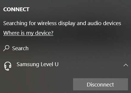

    • Power-cycling the headset changes its state to (presumably) connected, and the "Disconnect" button appears. But still: there are no audio devices available.
      Bluetooth headset is connected but is not recognized as Audio device in Windows 11 bKtdH.png
    • The device doesn't appear as an audio device:
      Bluetooth headset is connected but is not recognized as Audio device in Windows 11 QxTUz.png
    Kuba Ober, Feb 14, 2024

  4. Kuba Ober Win User
    TL;DR
    Make sure your Intel Wireless Bluetooth driver is at least of version 20.90, and enable all Bluetooth services for your headset device.
    Enable the needed Bluetooth Services on the Device

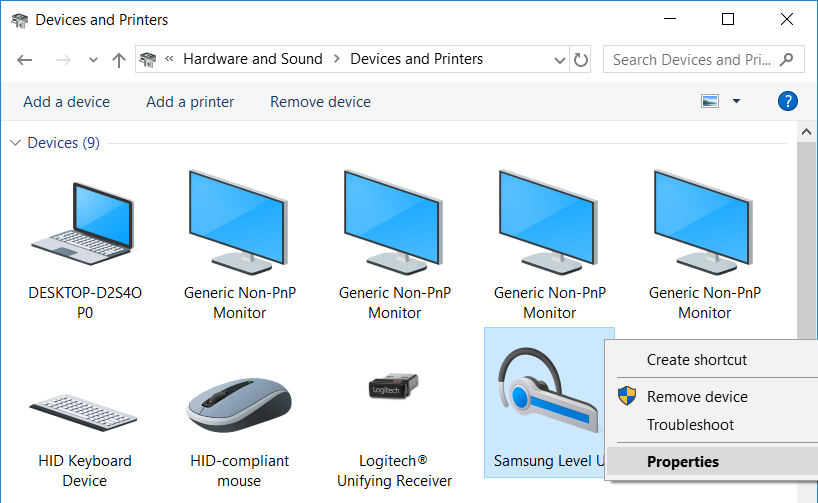

    The device doesn't appear as an audio device in spite of being connected, because its audio-related services are not enabled. Navigate in Explorer to Control Panel\Hardware and Sound\Devices and Printers, right-click on the headset device, and select "Properties":
    Bluetooth headset is connected but is not recognized as Audio device in Windows 11 YW1zS.png

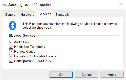

    In the device properties, the Bluetooth services related to audio are likely to be unchecked:
    Bluetooth headset is connected but is not recognized as Audio device in Windows 11 ukJm2.png
    Check all the services, and click "OK".
    Bluetooth headset is connected but is not recognized as Audio device in Windows 11 JZfqu.png

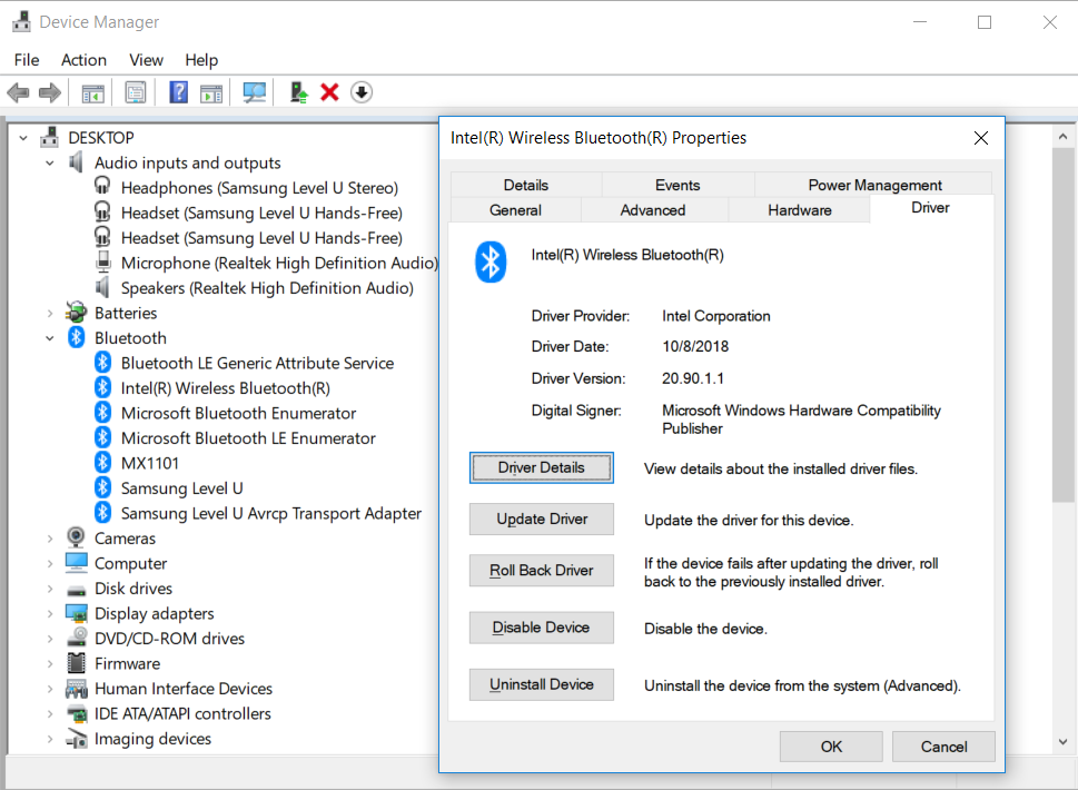

    Fixing the Supplied User Buffer is Invalid error: Bluetooth Radio (host) Driver Update
    If you get the error, the typical cause is an outdated Bluetooth radio hardware driver. As of 12/2018, the Intel driver version 19 is seemingly too old to reliably operate with the newest Windows Bluetooth stack.
    The newest drivers for Intel(R) Wireless Bluetooth(R) must be downloaded and installed from [Intel's site]. I chose the newest driver at this time: version 20.90.
    Bluetooth headset is connected but is not recognized as Audio device in Windows 11 XamEV.png

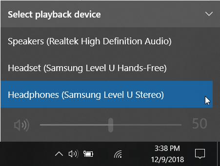

    After installing the driver, power cycle the headset, ensure that it shows connected in the notification center's "Connect" pane, and re-enable the services as described above. After clicking "OK" to re-enable the services, the headset will become available for use as an audio output.
    Bluetooth headset is connected but is not recognized as Audio device in Windows 11 Q27k0.png
