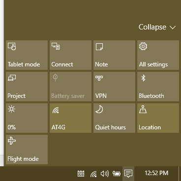

    step 3
    in device manger uninstall "generic Bluetooth adapter" under heading Bluetooth.
    step 4:
    restart the computer (don't switch off the computer; but use restart option)
    on restart most probably u will find on/off toggle switch back; if not follow the above steps again for 2-3 times; it will pickup the on/off switch.
    on restart you will find that the light of wireless adapter button on keyboard has turned red signalling that it is switched off.
    but in fact it is half off; it has passed control to switch on/off Wi-Fi and Bluetooth to screen taskbar Wi-Fi icon and in the notification bar where various buttons to control various action is shown.
    bluetooth seems completely disabled. Its not showing on/off toggle button. How to start it... a49595ac-e576-4cb8-a6b5-6b83d753c476.png
    from there u can switch on/off Bluetooth as well Wi-Fi.

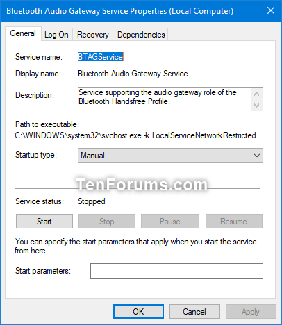

    Bluetooth toggle shortcut
    @gorgor
    You have two dependent services below that you can add commands for them like below.
    I don't know what the Service name for the "Bluetooth Support Service for user 63331" is on your computer, so I need you to see what it is, and post back with so I can add it to the command below.
    *Arrow Start, Stop, and Disable Services in Windows 10 | Windows 10 Tutorials
    • Bluetooth Support Service for user 63331
    • Bluetooth Audio Gateway Service
    Code:
    bluetooth seems completely disabled. Its not showing on/off toggle button. How to start it... 206465d1538488879t-bluetooth-toggle-shortcut-service_name.png
    Brink, Dec 5, 2024
