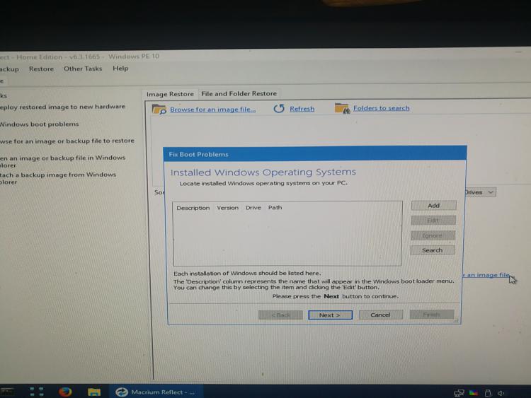

    I followed your instructions but Macrium could not find an operating system. See image below.
    boot configuration for your pc is missing or contains errors 157500d1507735833t-boot-configuration-data-your-pc-missing-contains-errors-fix_boot_problems_1.jpg

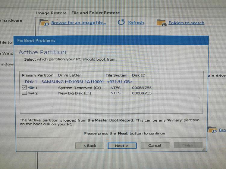

    I pressed next anyway and selected C: and pressed next again.
    boot configuration for your pc is missing or contains errors 157499d1507735833t-boot-configuration-data-your-pc-missing-contains-errors-fix_boot_problems_2.jpg

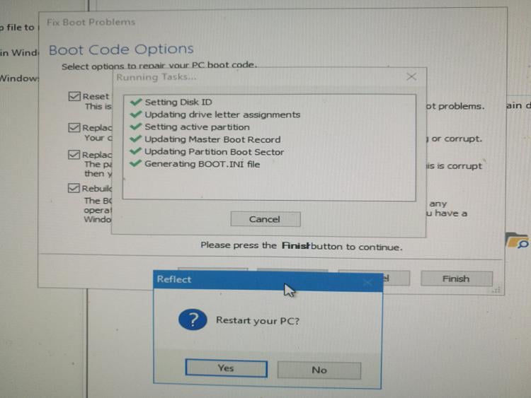

    I ran the fix and everything seems to have worked fine. I then restarted my computer.
    boot configuration for your pc is missing or contains errors 157498d1507735833t-boot-configuration-data-your-pc-missing-contains-errors-fix_boot_problems_3.jpg

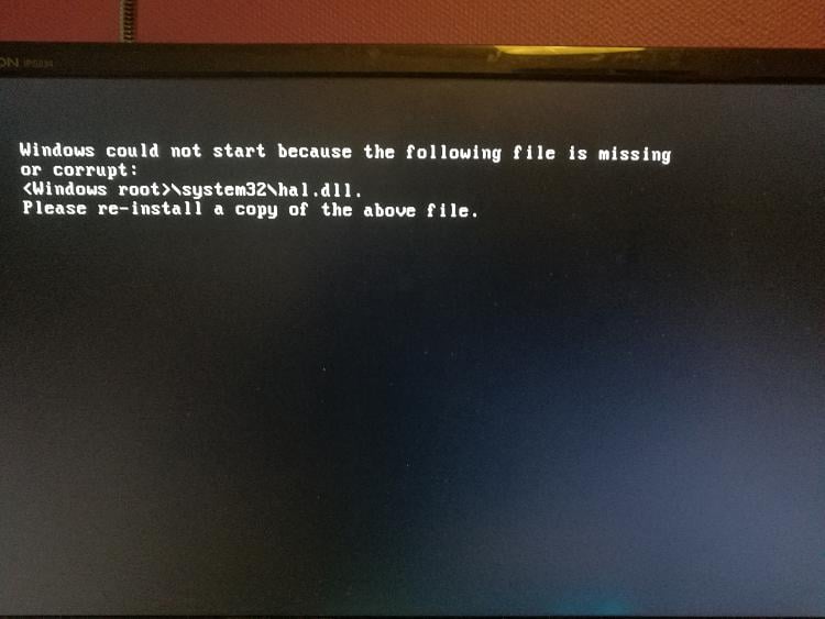

    I was greeted with a new error *Sad
    boot configuration for your pc is missing or contains errors 157497d1507735833t-boot-configuration-data-your-pc-missing-contains-errors-new_problem.jpg
    Any idea on what to do next?

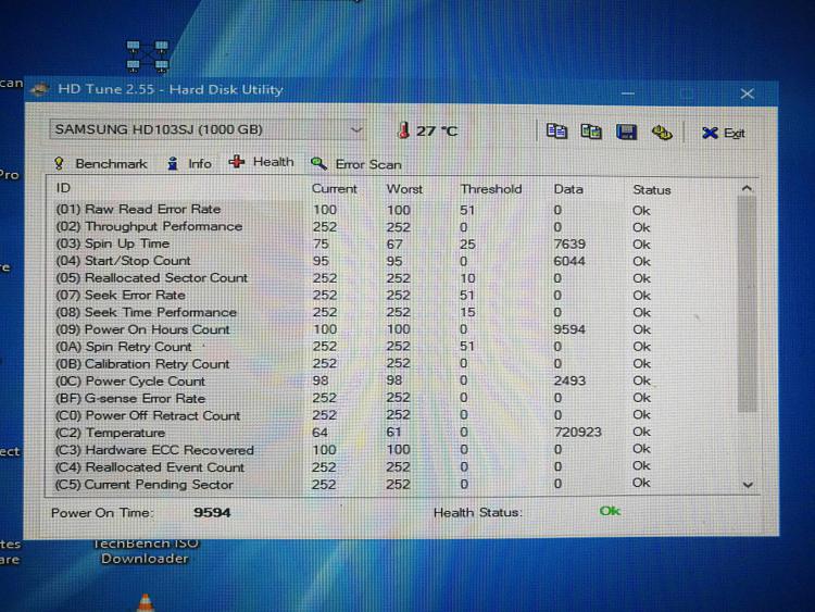

    To dalchina.
    Here's the result from the HD Tune Health tab.
    boot configuration for your pc is missing or contains errors 157502d1507736327t-boot-configuration-data-your-pc-missing-contains-errors-hdtunehealth.jpg
    I am currently doing an error scan with no damaged blocks after 15 minutes. I will leave it on and come back later and post the result.
    To bro67.
    Thank you for your suggestion. I will try it after the error scan is completed and post the results.
    So to summarize I currently have this error when trying to boot my computer.
    Windows could not start because the following file is missing or corrupt:
    <Windows root>\system 32\hal.dll.
