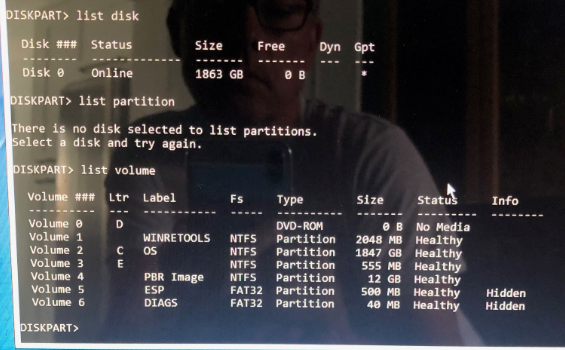

    Hi I have a PC with Windows 10 64 bit. I ran a feature update that stuck 48% even after leaving overnight. With no other option I turned off and rebooted hoping that it would repair/roll back the update. Alas I am now in a pickle. BSOD here's what I've tried so far. Hopefully someone can help me!
    Troubleshoot Advanced Options
    1. start-up repair
    'start-up couldn't repair your pc' logfile written to c:\windows\system32\logfiles\srt\srttrail.txt
    2. cmd prompt
    works sees 1 disk with several volumes see screenshot. Interestingly the cmd prompt on opening reads x:\windows\system32> not c drive?
    Boot failure following windows 10 feature update 5482e33c-4121-4a8e-b33d-47bfec6bb472?upload=true.png
