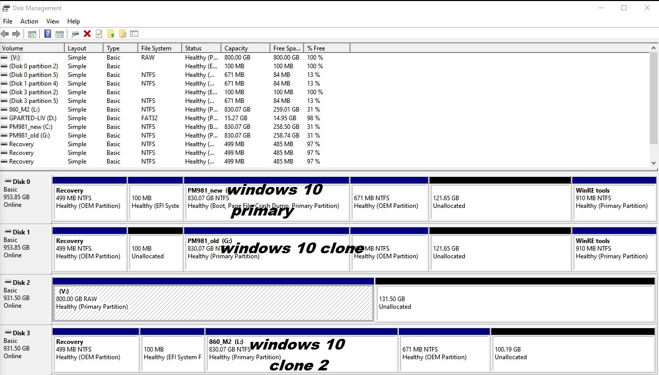

    It has 4 SSD disks, two PCIe and 2 SATA. I am only concerned about the PCIe SSD (2280 format). Here is the layout, it's disk 0 and disk 1 that are relevant.
    Disk 0 boots just fine.

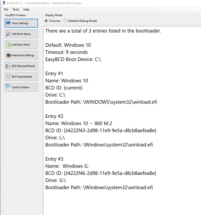

    I cloned the disk 0 to disk 1 using Macrium reflect. Then I created the BCDboot entry to create a multiboot operating system. It looks like this. Here is a view through EasyBCD:

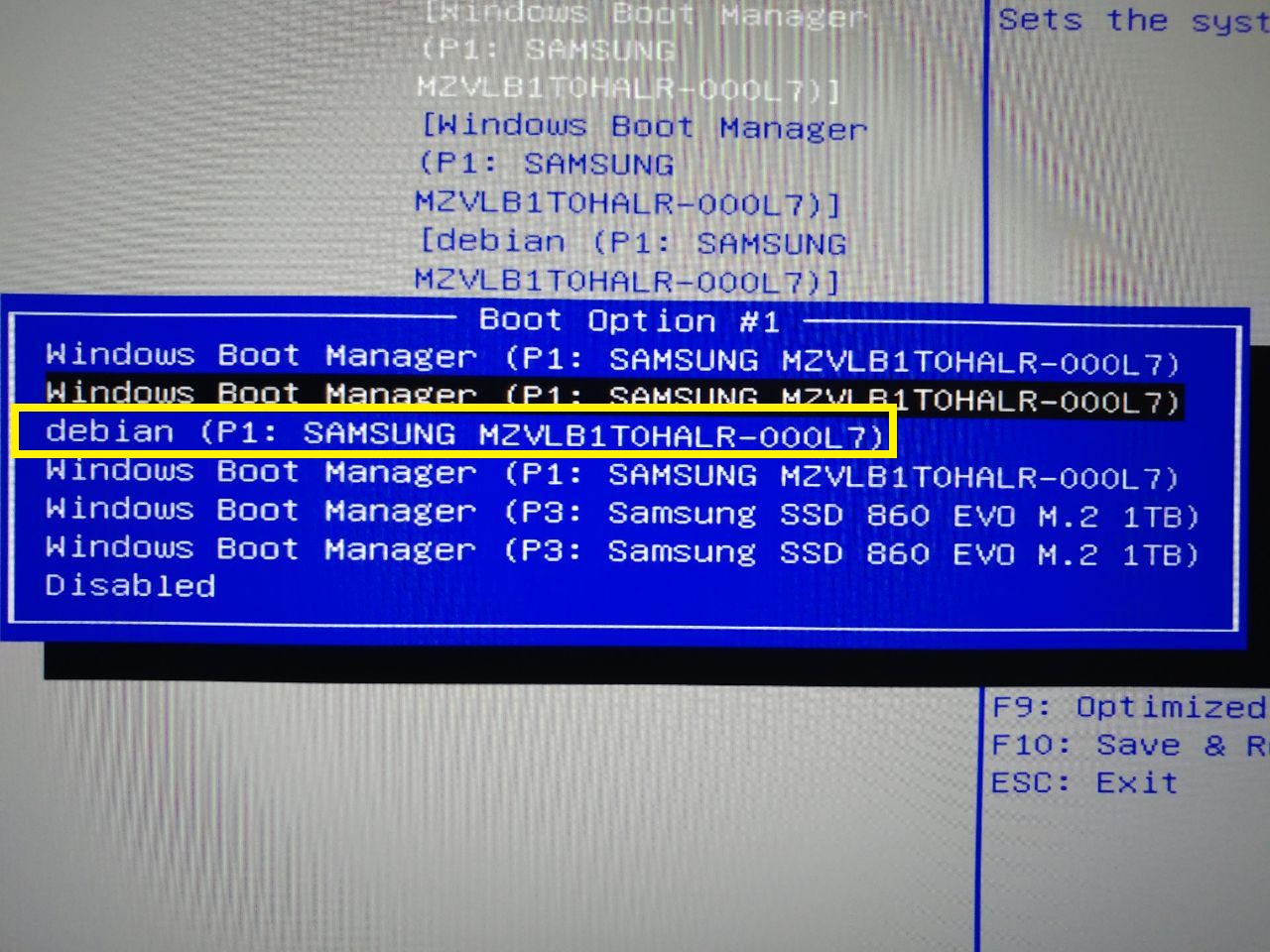

    After I did the clone, it stopped booting completely. Not even the primary drive is seen. Seems there is a conflict between two drives somehow. I went into BIOS and none of the 4 disks were seen. Furthermore when I hit F11, I could not even boot off the flash drive with Gparted to edit the partitions.
    When I removed the primary disk, I could boot into the cloned disk just fine, it's just that they don't work together. I did have to go into BIOS and adjust this. When I get a boot failure with 2 disks installed at the same time, I don't even see the option for Boot Option 1.. et cetera. When I remove either the primary or the clone disk, I get that option back and when I correct add Boot Option 1 pointing to the Samsung MZVxxxx, it boots correctly.

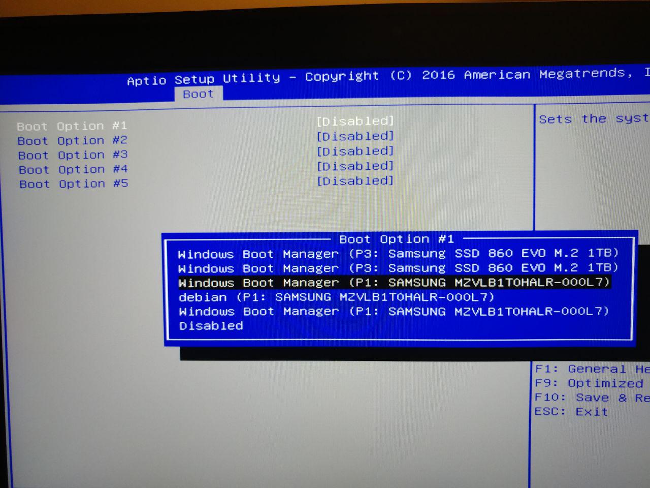

    So with 2 disks installed, I don't even see this:
    But this is the real question, why do I see this debian entry? I had previously used the disk for Debian install but since reused the disk for Windows clone and it should have retained none of the Linux stuff. The grub bootloader is still on the disk, or is that a conflict in NVRAM, grub is conflicting with bcdedit stuff?
    Disk 0 and Disk 1 are identical NVMe/PCIe disks with identical data on them but it can only boot off one if I nuke the EFI System Partition on the other disk, the 100MB sector. Then it boots. I re-run the Macrium Reflect clone/image process several times, copying *all* of the partitions, and always end up with the same result. I even formatted the disk and re-cloned it off primary, same result.
    I cannot multi-boot anymore, and the other disk is just a disk that can be used for data and nothing else. They both boot, just not together.
    How do I delete the Linux bootloader entry and where is it located?
