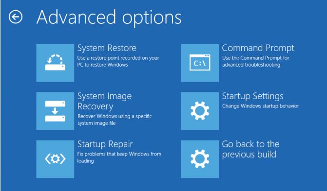

    it's my main desktop PC that won't boot up.
    from the bootable flash drive, i can get into the windows advanced troubleshooting menu, but nothing is working from there on, i can get command prompt to work
    BOOTMGR Missing & Element Not Found Installation in Different Drive 179417d1520164967t-bootmgr-missing-options.jpg
    it's an SSD if it makes any difference
