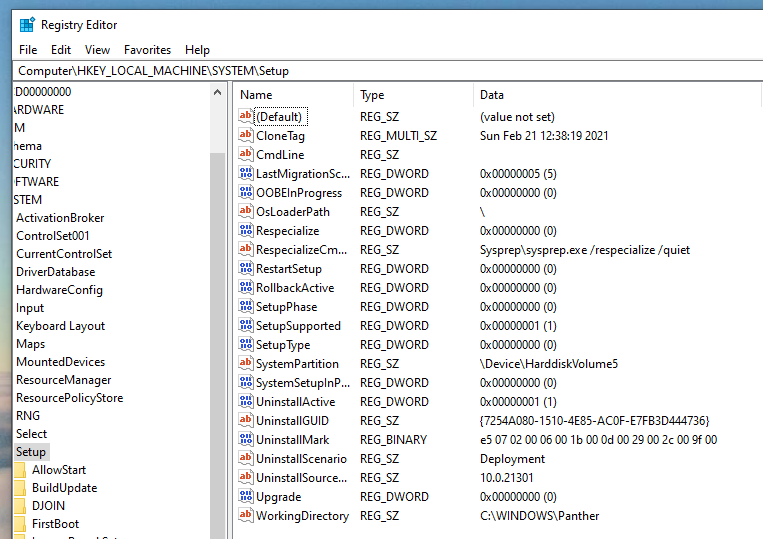

    So I was on my way setting up an Dev channel Insider installation on a second hard drive when I got stuck at "Checking the connection to Microsoft" no matter how good the connection is it will just spin infinitely and prompts me to connect to another one. I've tried everything from resetting the router, tethering from my phone to even Googling, all didn't help. During troubleshooting I managed to get the Settings app open. Then I thought "I'm on an older Insider build 21286, maybe this is a bug that they fixed in the next build?", so I went to Windows Update and let if flew to build 21301. But I was wrong.
    After the flight, instead of continuing the setup I got into defaultuser0's desktop the once-use user used for the OOBE setup process. Well, I thought I might have skipped the setup, so I went ahead and created my user through Settings like I normally would on a properly set up install, deleted defaultuser0 through Command Prompt and thought I made my day, until I found out the lock screen was inaccessible. I got bored so I went back to my main stable install on the other drive.
    Coming back a few weeks later, I was surprised by this:
    Breaking OOBE setup bricks the lock screen? [​IMG]Windows somehow still tries to login to its long-gone once-use user, thinking that the setup hasn't done yet, even if the registry told it it's done already: before that it autofilled something into the password field then said the username or password is incorrect
    Breaking OOBE setup bricks the lock screen? e0ad7d8d-90fd-407a-a5fa-d68fbce89500?upload=true.png
    I'm still able to login to my user, but again, no lock screen. The "managed" setting thing might be to prevent the end-user from accidentaly lock out defaultuser0 and don't know how to log back in as it's protected with a secret random password afaik. But I'm done already so why didn't it give me the setting back?
