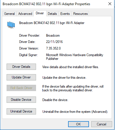

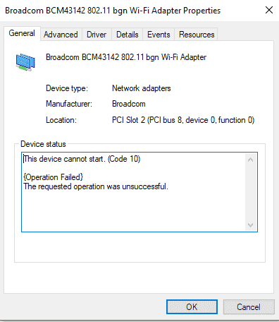

    For many weeks now I have been experiencing issues with the wifi connection to my HP Pavilion laptop. For no apparent reason the wifi adapter stops working and on running the troubleshooter I get the error message "Broadcom BCM43142 802.11 bgn wi-fi Adapter adapter is experiencing driver or hardware problems". I have tried fixing this - with frequent references to this site - but the problem refuses to go away. Checking the driver properties in Device Manager I am told that "This device cannot start. (Code 10) - {Operation Failed} - The requested operation was unsuccessful." The Problem Code from the Details tab of the driver properties is 00000000

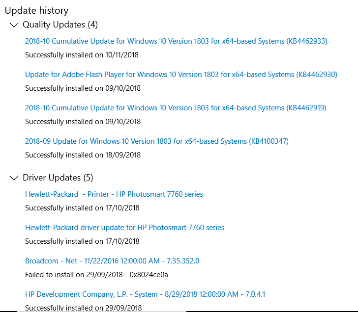

    My laptop OS is Windows 10, 64 bit, version 1803, and this is updated to include cumulative update KB4462933.
    The adapter driver is version 7.35.352.0, dated 22/11/16. An update dated failed to install on 29th September 2018, error code 0x8024ce0a, however when I try to update the driver from Device Manager I am told that the latest driver is already installed.
