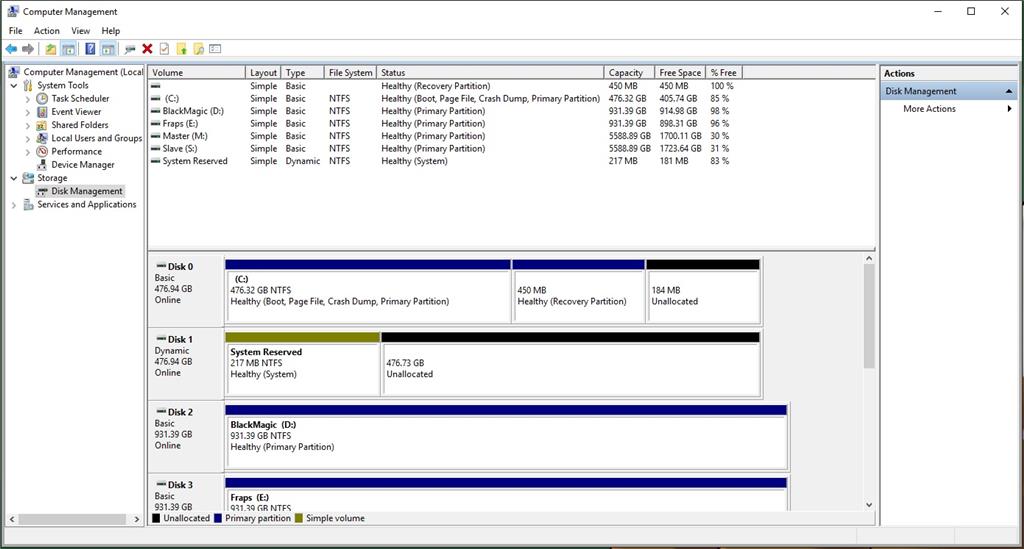

    I recently went to the trouble of swapping over from Windows 7 to Windows 10. In my Windows 7 Config I had a Mirror of the OS drive on an identical SSD. When it came to installing Windows 10 I tried pretty hard to delete all partitions on Disk 0 and Disk
    1. (Go figure; I wanted to set it up how I wanted it). I'm now left with the problem that I cannot delete the system reserved partition on Disk 1 meaning I cannot create a Mirror of my Disk 0.
    How do I delete this partition? Or just "nuke" the drive so I can start over?
    Broke a Mirror and it Deleted System Reserve, How can I Recover My Drive? e1fd85b4-9b16-473f-8cdc-be46b8e9ad33.jpg
    2fa3ad05-643d-4112-b7e0-25e0d749161f, Apr 29, 2022
