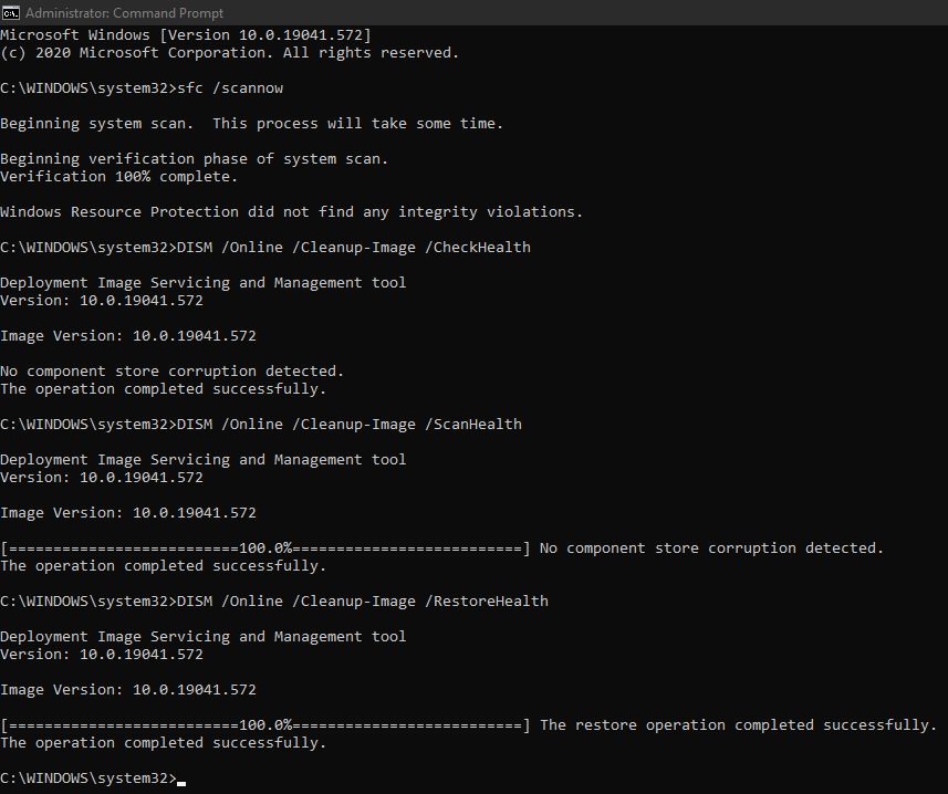

  4. BSOD: Computer Rebooted from a bug check.
    Computer rebooted from a bug check 0x0000003b.
    Hi, last week I have received three BSoD and one random reboot. I talked with a Microsoft Windows Certified Professional and Systems Administrator on this thread,
    but today I received two more BSoD. I have already attempted a few things and pulled together some files that might be helpful.
    I went ahead and pulled the .dmp and log files and added them to separate Google Drive folders. They can be found at the links below.
    .dmp files:
    https://drive.google.com/drive/folders/16Zs5o2zNz6a3yheGlRr0JNd6OFdYjhlv?usp=sharing
    logs:
    https://drive.google.com/drive/folders/1_uik6HsaM2VWDWBFY3ClUQZA65pbikTD?usp=sharing
    I also ran the below commands in an elevated command line and it did not present any obvious issues.
    commands:
    sfc /scannow
    DISM /Online /Cleanup-Image /CheckHealth
    DISM /Online /Cleanup-Image /ScanHealth
    DISM /Online /Cleanup-Image /RestoreHealth
    output:
    BSOD: Computer Rebooted from a bug check. 694b62b6-ae31-4123-97f9-370de236102f?upload=true.jpg
    Lastly, I went through the steps at this link to enable driver verifier and restarted my PC so that it will
    take effect.
    I am a Software Engineering student so I am comfortable with computers, but I am completely lost at what is causing this issue. Any help is greatly appreciated!
    Thanks,
    Cameron
    CameronMathis, May 27, 2022
