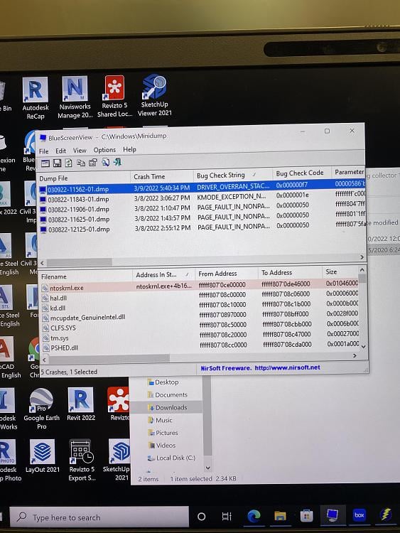

  3. DRIVER_OVERRAN_STACK_BUFFER bsod. All crashes pointing to ntoskrnl.exe
    I've seen five dump files with 5 different bug string checks using Blue Screen view.
    PAGE_FAULT_IN_NONPAGED_AREA(3times) KMODE_EXCEPTION_NOT-HANDLED(once),
    DRIVER_OVERRAN_STACK_BUFFER(once) as the last one.
    They all show ntoskrnl.exe highlighted in red.
    BSOD Crash "IRQL_NOT_LESS_OR_EQUAL", "DRIVER_OVERRAN_STACK_BUFFER", or "ntkrnlmp.exe" 361821d1646937452t-driver_overran_stack_buffer-bsod-all-crashes-pointing-ntoskrnl-exe-unnamed.jpg
