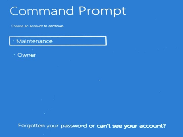

  4. Bree Win User
    BSOD + Locked out from Recovery Environment due to password
    New Microsoft password rejected in the Recovery Environment
    It's not just system restore that will ask for a password, almost all the recovery environment's troubleshooting options require you to give the password of a local administrator account before letting you proceed. You problem is that while you have changed your MS account password, the local account password hasn't changed.
    I'm not sure how you'd go about changing the local account password while it is linked to your MS account. You may be able to switch to a local account, change the password to match the one you used for the MS account, then switch it back to an MS account. I don't use an MS account, so I can't test that for you.
    What I can suggest is that you create a new local administrator account just for maintenance purposes and never link it to a MS account. Apart from anything else, it's always a sensible precaution to have a second administrator in case of problems signing in to your original one. When booting to any Advanced Start Up option that requires a password you can choose this local account instead, then you will know for certain which password to use.
    BSOD + Locked out from Recovery Environment due to password 177883t-new-microsoft-password-rejected-recovery-environment-recovery-environment-choose-account.jpg
    Bree, Dec 4, 2024
