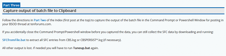

  3. Ztruker Win User
    Post problem reports here for Batch files for use in BSOD debugging
    Instructions are already in the BSOD repository, the next step.
    BSOD / please help reading debug info 314868d1610848467t-post-problem-reports-here-batch-files-use-bsod-debugging-image.png
    Agree all batch files that show output in Command Prompt or Powershell windows should have the info window updated. I look at doing that soon.
