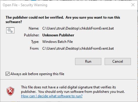

    When you launch LOGS.bat, you may see this:
    BSOD: What is that debugging file means ? 317146d1612205736t-batch-files-use-bsod-debugging-securitywarning.jpg
    If you do, click the Run button or uncheck Always ask before opening this file then click on the [B/Run[/B] button.

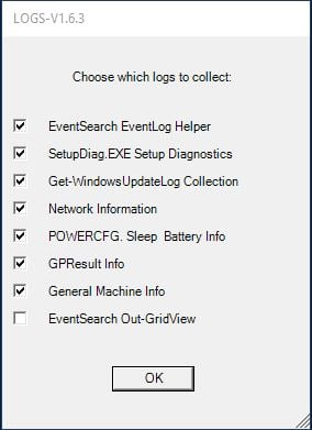

    You will see the following Window where you can select what functions you want to run. Normally you will run it as shown below. The Event Viewer logs are only collected when requested.
    EventSearch Output is unchecked by default as you can see.
    BSOD: What is that debugging file means ? 298520d1600721572t-batch-files-use-bsod-debugging-eventlog-1.jpg

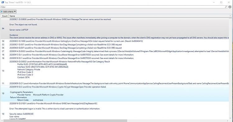

    If you select EventSearch Output then you will see the following Windows when the process completes:
    This is Top "Errors" via EVTX:
    BSOD: What is that debugging file means ? 298519d1600721264t-batch-files-use-bsod-debugging-eventsearch-1.jpg

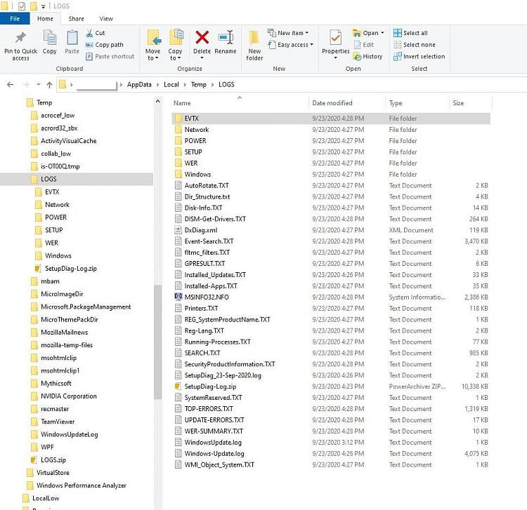

    Step Three [/i] Log Collection and description of logs collected:
    The log collection tool will determine the %temp% location and create a “LOGS” folder there into which all collected logs will be transported.
    This translates to C:\users\<username>\AppData\Local\LOGS
    Once the Script has finished collecting logs you should see a pop-up from Explorer.exe which will open to the %temp%/LOGS location. This is what you would zip up to upload to a file sharing site, then post a link to in your Tenforums thread.
    This is the LOGS folder and is opened in File Explorer automatically. This is what you would want to ZIP up then upload to a file sharing site. When done then post a link to it in your thread at Tenforums. It can be as large as 400MB, depending primarilly on the size of the EVTX folder, before you ZIP it. Once zipped, my test run went from 172MB down to 27MB.
    BSOD: What is that debugging file means ? 298742d1600893749t-batch-files-use-bsod-debugging-eventsearch-2.jpg

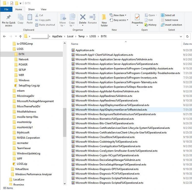

    This is an example of what Event logs (.evtx) are collected.
    BSOD: What is that debugging file means ? 298744d1600893925t-batch-files-use-bsod-debugging-eventsearch-3.jpg
    At the time of this writing the following logs are collected by the script:
    • Major Event Logs including Application Event, System and Store Logs
    • All Event logs are queried for the string “Error” and located errors are written to TOP-ERRORS.TXT:
    • Top-Errors will display the most frequent errors experienced on a per day basis and sort these in descending order with the date, the message ID and provider from which the error was located – these can be used to quickly locate errors which have been experienced on the machine in ALL EVTX locations:
    • Use the date and Provider Name to Investigate further in the actual logs on the machine – note that additional logs outside of Application and System Event are located under Applications and Services Logs/Microsoft/Windows in the Windows Event Viewer.
