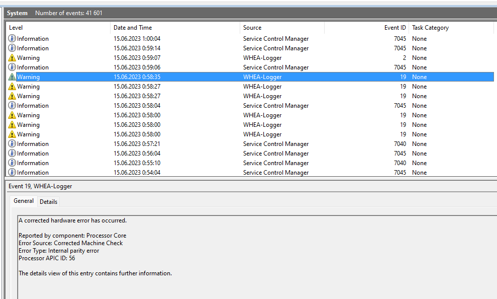

  3. BSOD everytime I run Unreal Engine C++ compilation in Visual Studio
    I'm trying to compile the Unreal Engine source code in Visual Studio and it always causes Windows to freeze and BSOD a few seconds later.
    According to analyzing minidump files, it looks the reason is random, so it seems like HW problem
    https://drive.google.com/drive/folders/1S7fIXEfpipp4ZfrhSWqfIhlgQdwAFj1i?usp=sharing
    But the issue is that it is not happening during any other action, even playing games.
    It is interesting that immediately when I run the build, the System event log starts to show these warnings, it is not happening during any other operation.

    I forgot to mention that during C++ compilation in the log are errors like
    08:26:18:941 1>...\UnrealEngine\Engine\Source\Editor\UnrealEd\Private\Cooker\CompactBinaryTCP.cpp(310): fatal error C1001: Internal compiler error.
    08:26:18:941 1>(compiler file 'D:\a\_work\1\s\src\vctools\Compiler\Utc\src\p2\main.c', line 225)
    08:26:18:941 1> To work around this problem, try simplifying or changing the program near the locations listed above.
    08:26:18:941 1>If possible please provide a repro here: Developer Community
    08:26:18:941 1>Please choose the Technical Support command on the Visual C++
    It is probably also related to this issue.
