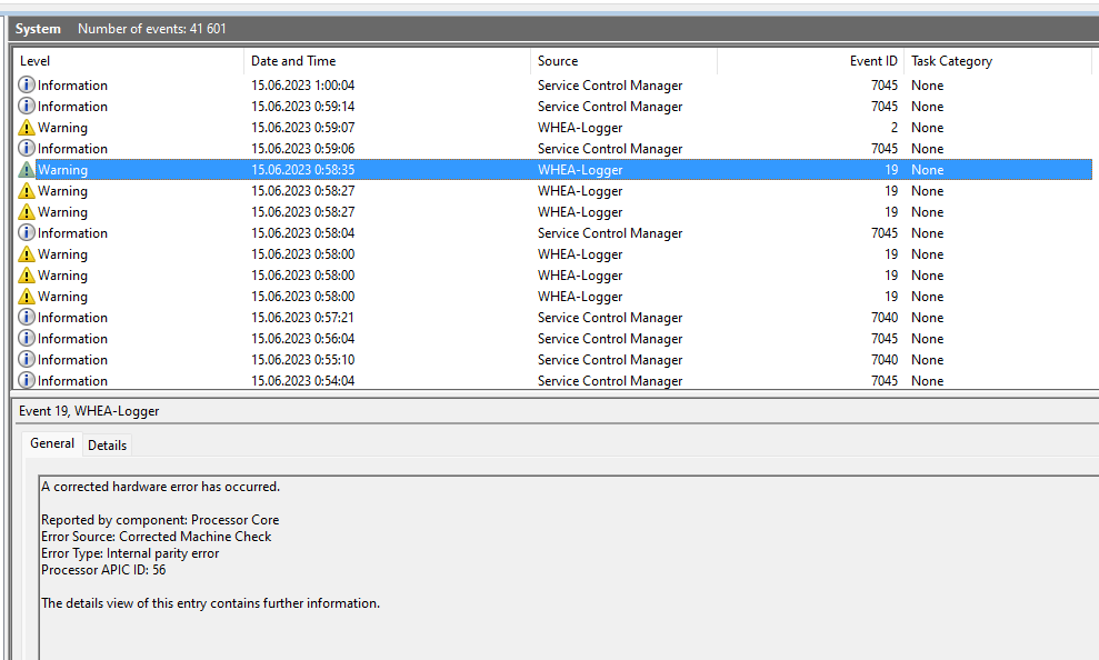

    It is interesting that immediately when I run the build, the System event log starts to show these warnings, it is not happening during any other operation.
    BSoD when compiling Unreal Engine 5.1 Source [Memory_Managment] cebd1fb9-8840-41dc-a908-8f268e70e054?upload=true.png

    I forgot to mention that during C++ compilation in the log are errors like
    08:26:18:941 1>...\UnrealEngine\Engine\Source\Editor\UnrealEd\Private\Cooker\CompactBinaryTCP.cpp(310): fatal error C1001: Internal compiler error.
    08:26:18:941 1>(compiler file 'D:\a\_work\1\s\src\vctools\Compiler\Utc\src\p2\main.c', line 225)
    08:26:18:941 1> To work around this problem, try simplifying or changing the program near the locations listed above.
    08:26:18:941 1>If possible please provide a repro here: Developer Community
    08:26:18:941 1>Please choose the Technical Support command on the Visual C++
    It is probably also related to this issue.
