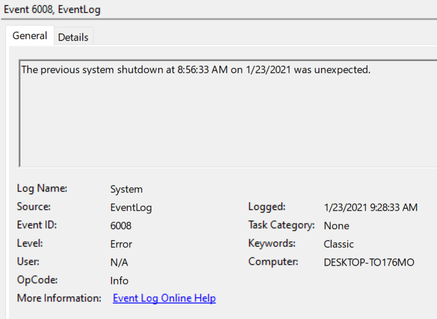

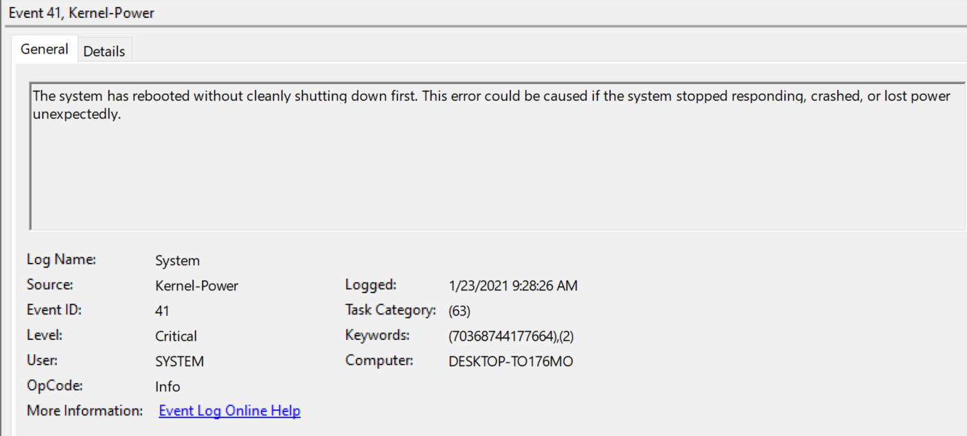

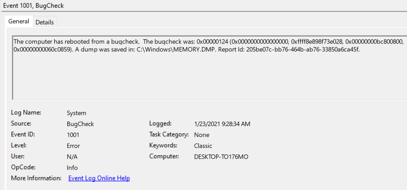

    BSOD with errors WHEA-Logger, Kernel-Power
    I'm having BSOD issues with my AMD system using Windows 10. These issues occur seemingly randomly, just being on the desktop, nothing related with gaming.
    AMD 5900X CPU
    RTX 3080
    After the BSOD, I see a couple critical errors which I will attach below. Anyone have any advice on how to fix this issue? Anyone dealt with "70368744177664" and "whea-logger" before? BSOD with errors WHEA-Logger, Kernel-Power 834d976d-e44d-4a7d-886a-950f610319f2?upload=true.png BSOD with errors WHEA-Logger, Kernel-Power ab5fc5a0-f15a-49e0-b75d-963e63ffdaf6?upload=true.png BSOD with errors WHEA-Logger, Kernel-Power 1f40e936-fd0c-4875-a601-08c857a7c427?upload=true.png BSOD with errors WHEA-Logger, Kernel-Power fea77645-9e14-454e-9273-4fed66991794?upload=true.png
