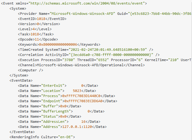

  1. C# ETW / Microsoft-Windows-Winsock-AFD Events not complete
    when you run:
    logman start -ets HackingSeriesSession -o hss.etl -p Microsoft-Windows-Winsock-AFD
    wait 10 seconds, then:
    logman stop -ets HackingSeriesSessiontracerpt.exe hss.etl -o evidence.txt
    you get:
    C# ETW / Microsoft-Windows-Winsock-AFD Events not complete ab485e87-f5df-4804-966e-3a55f6bc7b47?upload=true.png
    which is quite Ok, but now i would like to use the same AFD thingy in C# with MS EventTraceProvider Code. Found some examles online and only switched this line:
    var restarted = session.EnableProvider"Microsoft-Demos-SimpleMonitor";
    with this:
    var restarted = session.EnableProvider"Microsoft-Windows-Winsock-AFD";
    but the result in the console output only holds a few values:
    GOT Event Delay=2,0sec: <Event MSec= "939,9642" PID="13932" PName=
    "" TID="16040" ActivityID="36e4cdc0c708ffff0000000000000000"
    EventName="AfdSend/Connected" ProviderName="Microsoft-Windows-Winsock-AFD"
    FormattedMessage="send: 0: Process 0xffffc708408350c0,
    Endpoint 0xffffc70849f8d010, Buffer Count 1, Buffer 0xffffc7084ab8aba0,
    Length 63, Seq 3.000, Status 0 " EnterExit="0" Location="3.000"
    Process="0xffffc708408350c0" Endpoint="0xffffc70849f8d010" BufferCount="1" Buffer="0xffffc7084ab8aba0" BufferLength="63" Status="0"/>
