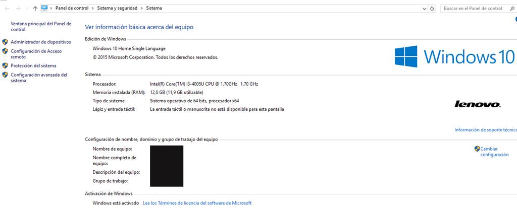

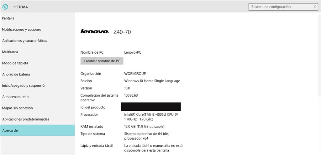

  3. Webcam Logitech C920 HD Pro not compatible with OS(Win 10)
    Hi, today I bought a Logitech C920 HD Pro Webcam. When I try to install the original support software, downloaded from Getting started - HD Pro Webcam C920, it says the software Im trying to install is not compatible with my OS and
    I have to search the original and compatible.
    After this, I downloaded the same software but for Win 8, it actually works with compatibility mode... but, when the software Im trying to install ask me to plug in the camera, the computer doesnt recognize it. Here is when Win update comes up and gives
    me this response:
    • Logitech - WebCam - Logitech USB Camera (HD Pro Webcam C920) - Error 0x800f0246
    I´ve searched on that code of error, I couldnt find anything helpful. From every post 20% of owners this periferal works fine, the rest of us is just loosing faith on Win 10.
    Please, help, I need it for work. Thanks a lot for your time.
