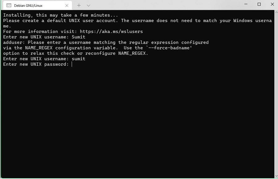

    Setting up WSL for first use
    1. After the WSL distribution download is complete, you would need to configure it. Afterward, when the download is done, open the distribution from the start menu.
    2. Now, the next step is to set up a username and password for opening the Distro. Enter your desired username and password, and press Enter. The username should be in small letters.
    3. You would see username@PCName in the command line, waiting for a command.
    4. Enter sudo apt update && sudo apt upgrade command to update the Distro with the latest packages.

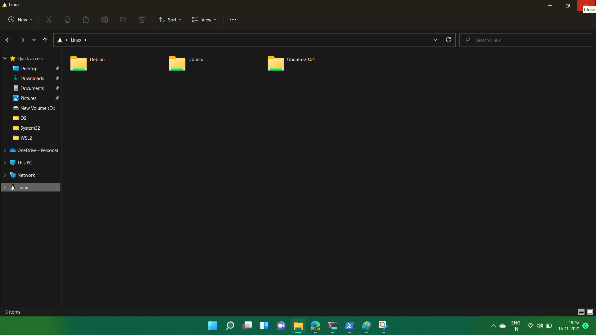

    Navigating with files
    When the Distro is installed, Windows would add an option in the File Explorer so that you can directly access the files.

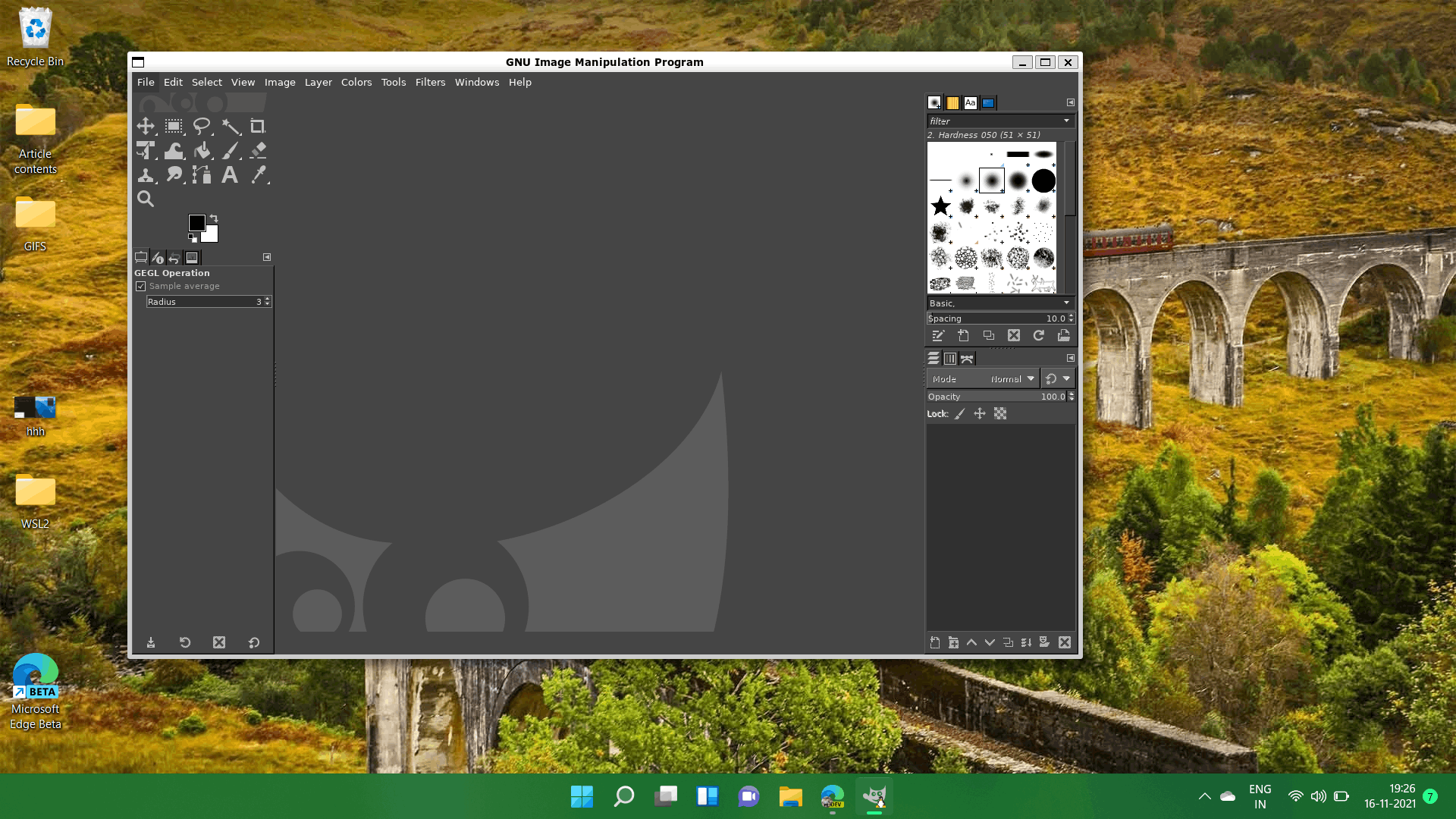

    Run GUI Apps in WSL
    If you are running Windows 11, you can run Linux GUI apps natively on Windows 11. See the steps below
    1. Make sure the latest GPU drivers are installed from the GPU manufacturer.
    2. If you had set up a Linux distribution before, you would need to update WSL to support GUI. For the same, execute wsl --update in an elevated Powershell. You can also check for Windows updates.
    3. The next step is to download the specific app. Some of the widely used GUI apps on Linux can be installed using the commands below:

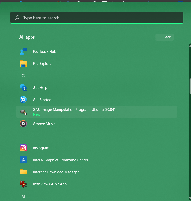

    When the installation is complete, you will see the app listed in the Start menu. You can also cycle between apps using Alt+Tab as well.
    Can a celluloid tablet/tabtablet with SIM support be used to run a windows or linux either... ef99fdd5-3919-4067-8b82-4529ea6849e9?upload=true.png
    GIMP installed using Ubuntu
