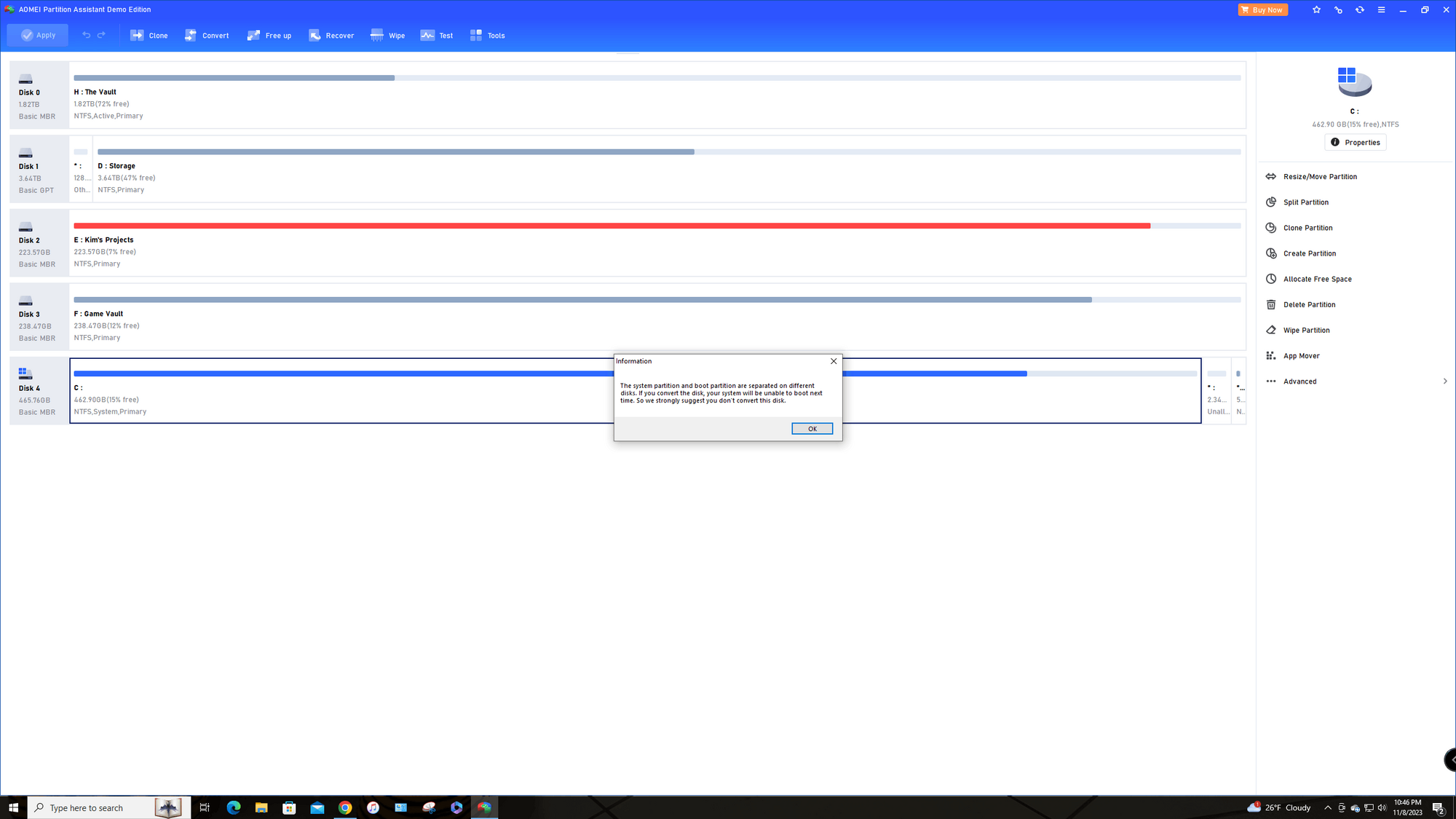

    Hello!
    Attempting to upgrade windows 10 to windows 11. When converting c drive(operating system/boot/system drive) from MBR to GPT I discovered that my boot partition and system partition are on separate drives, so I cannot convert. To fix this I am installing a new primary boot drive and reinstalling windows 10 on to it. To avoid issues I have been told to unmount all drives but the new drive while installing fresh copy of window 10. I would then want to remount all old drives and transfer all the program files from the old drive to the new one. I am afraid of creating conflicts or new issues when transferring over the content from the old drive. Will there be issues of duplicate/conflicting windows files? Is there risk of creating any new partition conflicts or issues? Any advice on software to use, or best advice for fixing this issue? I am open to other solutions. I just want to ultimately end up with a new GPT drive with both boot partition and system partition so I can upgrade, but also want to keep all the programs and data from the old drive so I don't have to reinstall everything. Thanks for any advice!
    Josh SD, Apr 25, 2024

  4. Can I recombine separate boot and system partitions back into one bootable system drive?
    Fix for boot partition and system partition on separate drives
    Run: https://www.microsoft.com/windows/windows-11#pchealthcheck
    Windows 11 System Requirements - Microsoft Support
    Post images or share links into this thread using one drive, drop box, or google drive.
    If you're planning a supported Windows 10 to Windows 11 upgrade then an option is to make a backup image and restore only the primary or data partition after a clean install.
    The clean install is performed after modifying the BIOS so that the new partition architecture is already GPT (BIOS: UEFI; Drive GPT). The backup image was made while Legacy / MBR. Restoring the image of only C: into the GPT partition is followed by a startup repair as needed.
    Some third party software (Macrium) have features to make backup images and restore only one partition.
    For example restore only C:.
    Macrium use to be free.
    Other backup imaging software may or may not have this feature: Acronis, EaseUS, Paragon, etc.
    1) Backup the whole disk drive (all partitions) > save to another disk drive
    2) Find a flash drive that you can format (> or = 8 GB).
    3) Find a working Windows computer
    4) Using the flash drive that you can format (> or = 8 GB) create a bootable Windows 11 Media Creation Tool (MCT) (Windows 11 iso):
    Download Official Windows 11 ISO file from Microsoft Tutorial | Windows 11 Forum (elevenforum.com)
    Download Windows 11 (microsoft.com)
    5) Detach all drives except the drive for the new Windows installation
    6) Boot to the BIOS > Modify settings: Legacy > UEFI native (without CSM)
    7) Boot to the MCT
    8) Delete all partitions making an unallocated disk drive
    9) Clean install Windows 11
    10) Restore only the C: partition
    11) Perform a startup repair as needed
    questions_, Apr 25, 2024
