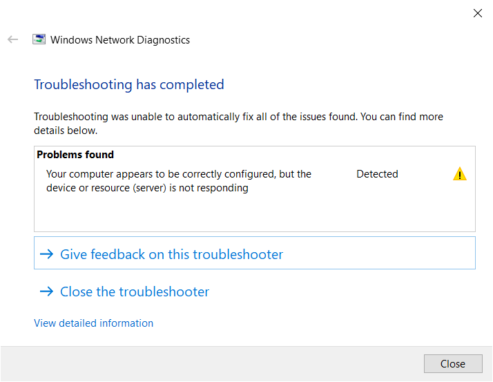

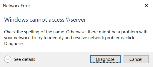

  1. can not access share folder on local area network
    it's a brand new workstation / business laptop from hp
    with the most current updates
    trying to add this to our local area network w. server 2008 r2
    all workstations are working fine. lan is fully functional
    this new workstation can access the internet
    it can ping the ip address of the server
    however, file explorer will not open shared folders on the server; it will not get to the point where it asks for the user name or password, or even list the server as a network node
    after trying to access the share, a cryptic time out error message appears saying "your computer appears to be correctly configured, but the device or resource server is not responding"
    can not access share folder on local area network b3604dca-4eca-4c60-babc-5abc735dd7e9?upload=true.png
    can not access share folder on local area network 3b8115ec-cbd2-4ae8-a127-be89c0c6b9ba?upload=true.png
    can not access share folder on local area network 0493e69b-d4ba-4753-bc3b-433df3b68377?upload=true.png i've confirmed all the settings in network and sharing center, i've had hp support remote into this workstation, as well as microsoft support remote in. also, i've tried network resetting and other recommended fixes. i don't know what else to do. hp support is recommending re-imaging the workstation, however, i am not too optimistic about this plan, but this is the only other alternative. i don't know what else to try. it's completely bizarre. how does anything like this happen
