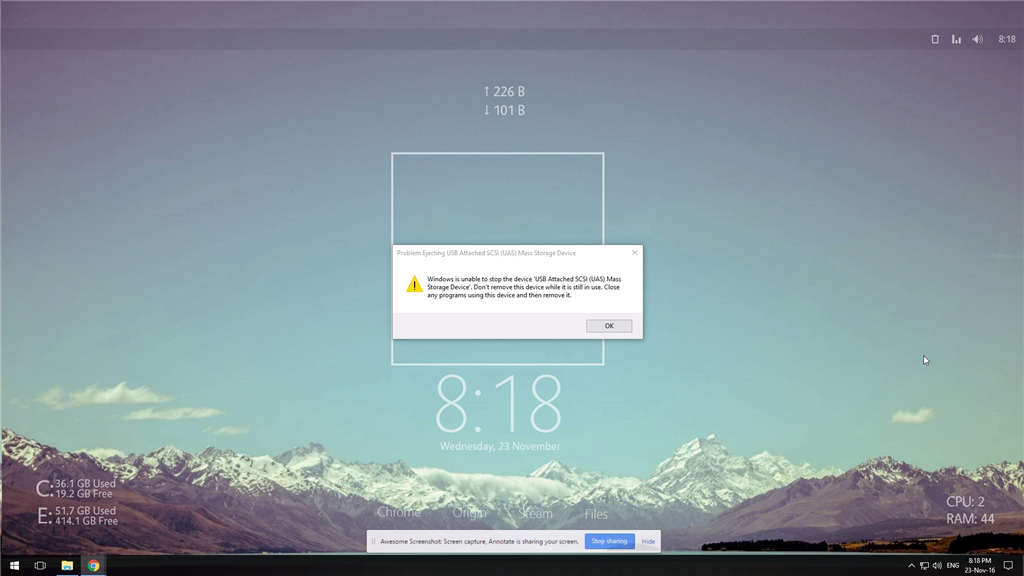

    I currently have an external hard drive attached to my computer through a front USB port. When I try to eject it with the "Safely Remove Hardware and Eject Media" icon, it says "This device is currently in use. Close any programs or windows that might be using the device, and then try again." even though there are no programs open on my computer and the task manager only has system programs running. When I try to eject it from 'My Computer', there is no option to eject when right clicking on the device. When I got to "RunDll32.exe shell32.dll,Control_RunDLL hotplug.dll" from run and open the "

  4. Can not eject external hard drive
    Can't eject external hard drive
    Every time that I try and eject my Samsung external hard drive, I get a message pop up saying to close any programs using it. I also can't eject using drive tools in File Explorer. I have checked and there is nothing running. I can also eject the hard
    drive in other computers, after using it for basically exactly the same use.
    EmilyFleet, May 19, 2021
