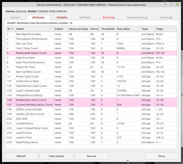

  3. Windows boot issue - dead hard drive?
    Hi all - was given a laptop by a friend to take a look at. Pretty sure the culprit is a dying hard drive, but wanted a second opinion. Laptop fails to boot and she was getting constant 'Startup Repair' errors in Windows 10 on attempted bootup.
    Now, however, when I try and boot it, it stays stuck at the ASUS logo screen (it's an ASUS F555L laptop) and sits there FOREVER before going straight to the 'Troubleshooting' screen (the one with options like 'Command Line', 'Startup Repair', etc). I went into the command line (which took forever) and tried to run a chkdsk and it gave me a "chkdsk is not available for raw drives" error message, which I've never seen before. Looking it up gives me the common thought that the file system is borked or unreadable.

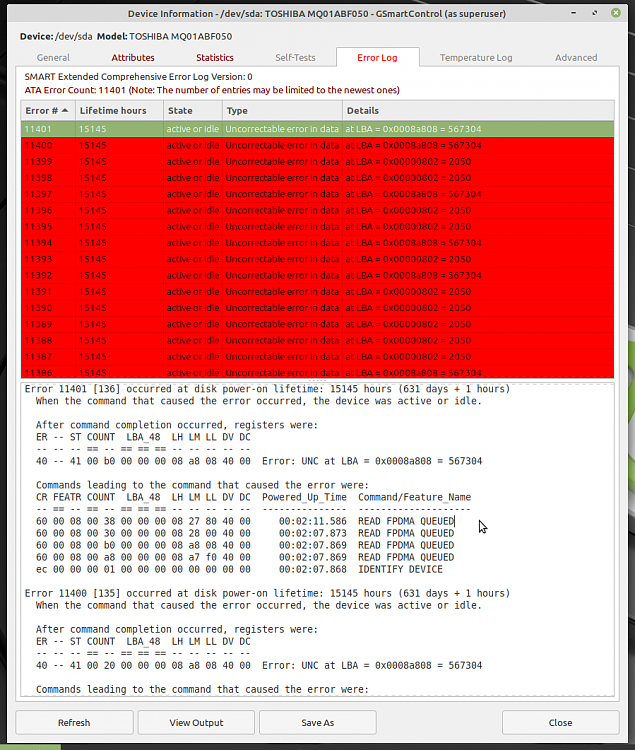

    I booted up a Linux Mint LiveUSB to see if I would have any better luck there, but it doesn't even list the drive/file system as mountable. I used GSmartControl to check the status on the disk and am seeing a lot of relocated sector errors (among others) and like 49 listed 'uncorrectable error in data' issues:
    Can not reset windows, can not boot, automatic repair fails, is my hard drive dead? 261417d1577826264t-windows-boot-issue-dead-hard-drive-screenshot-2019-12-31-21-00-27.png
    Can not reset windows, can not boot, automatic repair fails, is my hard drive dead? 261418d1577826264t-windows-boot-issue-dead-hard-drive-screenshot-2019-12-31-21-01-43.png
    Pretty cut and dry that the hard drive is toast and that is the likely culprit, right?
    Thanks! Can not reset windows, can not boot, automatic repair fails, is my hard drive dead? :)
