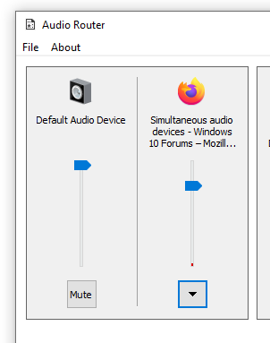

    Can W11 send audio to two devices simultaneously? 355870d1640709769t-simultaneous-audio-devices-router.png
    I found it a bit confusing myself. Essentially, if there is a mute button at the bottom of something, that is a physical output. All of the possible outputs on your machine should show. Some, like Bluetooth, come and go as the device is connected.
    If there is an arrow at the bottom, that is a piece of software outputting audio, these come and go depending on if the software is running. If you click the arrow, you use duplicate, a box will pop-up and ask where to send it to, you can then select whatever output you want. There is route option, not too sure about that, I think it sends the audio rather than duplicate and sending it to two different places.

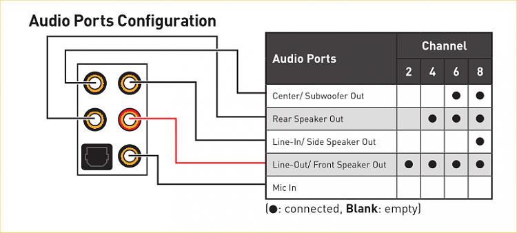

    It seems that MSI doesn't use a green 3.5mm jack like everyone else... *Smile
    This is the jack you would use for the soundbar 2.1 (audio)...
    Can W11 send audio to two devices simultaneously? 355857d1640707362t-simultaneous-audio-devices-image1.png
    From your manual...
    Can W11 send audio to two devices simultaneously? 355866d1640708413t-simultaneous-audio-devices-image1.png
    For the soundbar charging or power, use any of the PC's USB ports.
