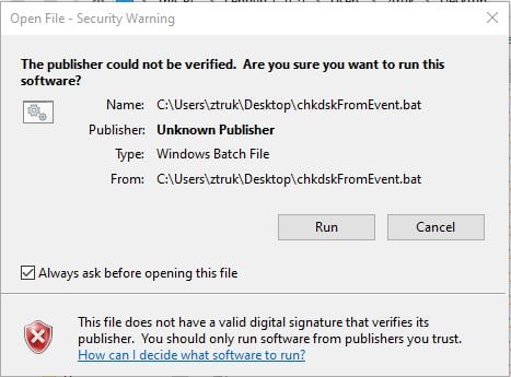

    When you launch LOGS.bat, you may see this:
    Can you help me debug my DSOD - Opening Threat Following This Article : BSOD Finding and... 317146d1612205736t-batch-files-use-bsod-debugging-securitywarning.jpg
    If you do, click the Run button or uncheck Always ask before opening this file then click on the [B/Run[/B] button.

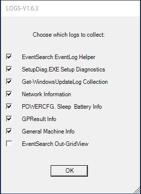

    You will see the following Window where you can select what functions you want to run. Normally you will run it as shown below. The Event Viewer logs are only collected when requested.
    EventSearch Output is unchecked by default as you can see.
    Can you help me debug my DSOD - Opening Threat Following This Article : BSOD Finding and... 298520d1600721572t-batch-files-use-bsod-debugging-eventlog-1.jpg

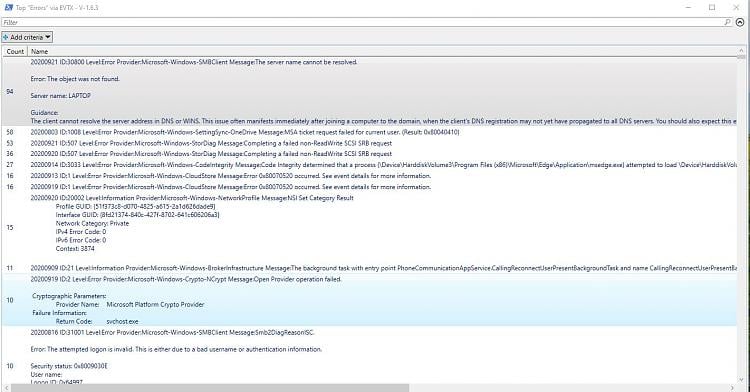

    If you select EventSearch Output then you will see the following Windows when the process completes:
    This is Top "Errors" via EVTX:
    Can you help me debug my DSOD - Opening Threat Following This Article : BSOD Finding and... 298519d1600721264t-batch-files-use-bsod-debugging-eventsearch-1.jpg

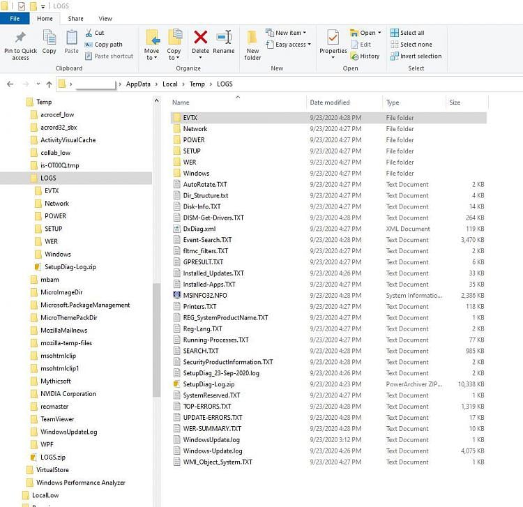

    Once the Script has finished collecting logs you should see a pop-up from Explorer.exe which will open to the %temp%/LOGS location. This is what you would zip up to upload to a file sharing site, then post a link to in your Tenforums thread.
    This is the LOGS folder and is opened in File Explorer automatically. This is what you would want to ZIP up then upload to a file sharing site. When done then post a link to it in your thread at Tenforums. It can be as large as 400MB, depending primarilly on the size of the EVTX folder, before you ZIP it. Once zipped, my test run went from 172MB down to 27MB.
    Can you help me debug my DSOD - Opening Threat Following This Article : BSOD Finding and... 298742d1600893749t-batch-files-use-bsod-debugging-eventsearch-2.jpg

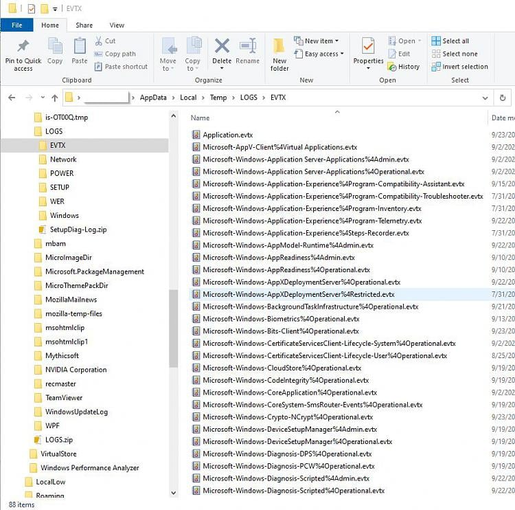

    This is an example of what Event logs (.evtx) are collected.
    Can you help me debug my DSOD - Opening Threat Following This Article : BSOD Finding and... 298744d1600893925t-batch-files-use-bsod-debugging-eventsearch-3.jpg
