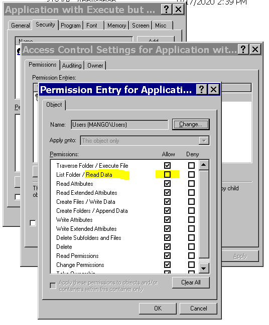

    This is how it worked on Windows NT, Windows 2000, Windows XP, and Windows Vista:
    - You could grant all access rights (including `FILE_EXECUTE`)
    - but exclude `FILE_READ_DATA`:
    Cannot execute file when FILE_READ permission is removed on Windows 7 or newer ce71cc1f-a6b0-4361-8d4d-4167a3645b9f?upload=true.png
    And the user can "execute" a file they cannot "read".

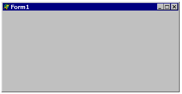

    In Windows 2000 they can execute a file they cannot read:
    Cannot execute file when FILE_READ permission is removed on Windows 7 or newer bc9e9fe4-b4c7-4cc8-9138-cbc4c291c974?upload=true.png

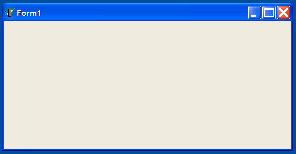

    In Windows XP: they can execute a file they cannot read:
    Cannot execute file when FILE_READ permission is removed on Windows 7 or newer ac096fed-2c0b-419e-875c-a32c0620cfde?upload=true.png

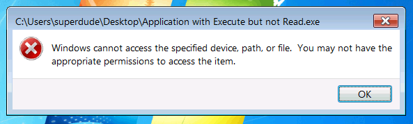

    Until Windows 7
    That all worked great until Windows 7; where the file can no longer be executed:
    Cannot execute file when FILE_READ permission is removed on Windows 7 or newer 6cb9cfa1-b2af-47f5-998d-32a03711be86?upload=true.png
    Looking at the stack trace of the function that gets the `ACCESS_DENIED` result, it's CreateProcess itself that is attempting to "read" the file:
