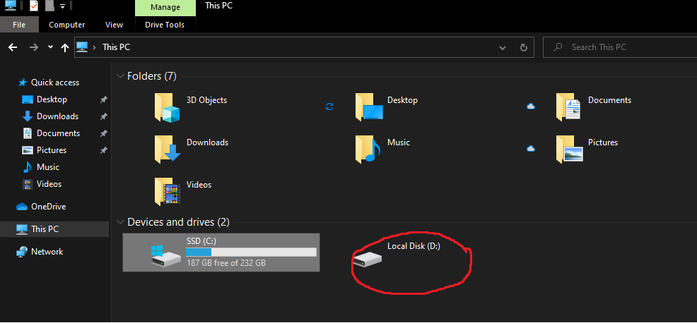

    I factory reset my pc today around 6 hours ago and I tried to open my HDD drive because there was no blue line indicating the storage or anything.
    cannot select disk D without crashing the file explorer and other 37aac8b0-ea3e-4773-a3e9-e2d4a6b10865?upload=true.png So I right clicked it and waited for it to load, after around 2 seconds my file explorer crashed, at the time I was with a couple of friends on discord, I couldn't do anything with the file explorer, discord was working perfectly and so was everything else. Yes I did try to end the task, then run explorer.exe.

    What I saw from the Disk Management, You did not do a clean install, you probably did an in place upgrade. The 100MB System Reserved is normally used in Window 7. For a fresh install the Disk partition scheme should be as follows:
    1. 500 MB System Reserved partition
    2. C- Drive.
    Since you did not have to many apps installed, I would re-install Windows 10 as suggested above. It is better to have your Windows installed on the first sata port (Disk 0) so I suggest to open the case and connect the cable from disk 0 to disk 2 where you have C: drive. Disconnect the other cables for now and do the steps below:
    1. Boot up with Windows installation media
    2. On the first screen. Press SHIFT + F10 and type
      diskpart
      select disk 0
      clean
      exit
      exit
    3. Continue with Installation, select the unallocated partition then click Next (Do not create partition/format. Let Windows create the needed partitions.
    4. Once done, reconnect the other cables for drive D and E.
    5. Reboot, your Disk 0 should contain 500MB system reserved and C drive.

    This problem may be a sign of hard-disk damage. When a file resides on a damaged area of the hard disk, Windows cannot access the file. When this occurs, the program crashes.
    Let us try the following steps, and check if it helps.
    Step 1: End the Windows Explorer process and create the new one.
    • Press Ctrl+Shift+Esc, under Process tab, search for
      Windows Explorer.
    • Right click on it and click on End task.
    • Click on File in the Task Manager at top left corner of the window and select
      Run new task.
    • Type explorer.exe and click on OK.
    Step 2: Run the Chkdsk.exe program to try to recover files from any damaged areas of the disk. To do this, follow these steps:
    • Press Windows + X keys.
    • Click on Command Prompt (Admin) to bring up an elevated command prompt.
    • In the command prompt type chkdsk /r and then press
      ENTER.
    • Press Y, and then press ENTER.
    • Restart your computer. During startup, Windows will scan your disk for errors, and Windows will try to recover any files that are located on damaged areas on the disk.
