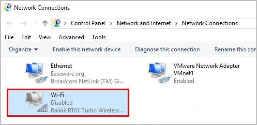

    • We can try to navigate the below mentioned steps to reach the network connections and check if the Wi-Fi adaptor is disabled or not.
    Control Panel > Network and Internet > Network Connections >
    Cannot turn on network connection wifi. Icon is gone. a8c0cbab-ccbe-445c-9355-ee9752c3fda0?upload=true.jpg

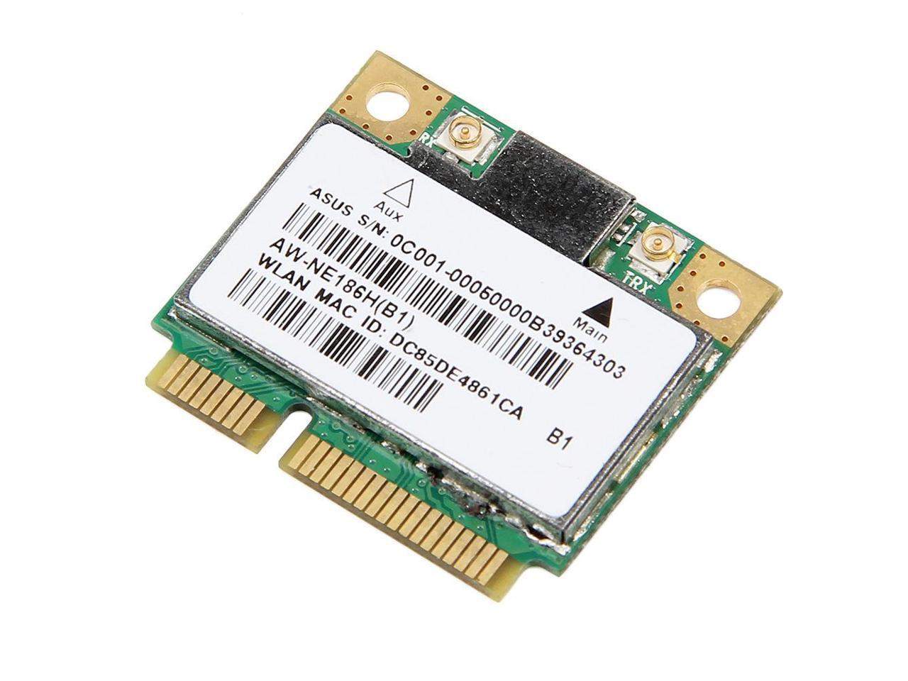

    • You can contact the OEM (Original Equipment Manufacturer) and inform them about this problem so that they are aware of this situation, irrespective of the warranty provided for a device. There is a possibility that the WLAN adaptor card for laptop/desktop has a hardware fault.
