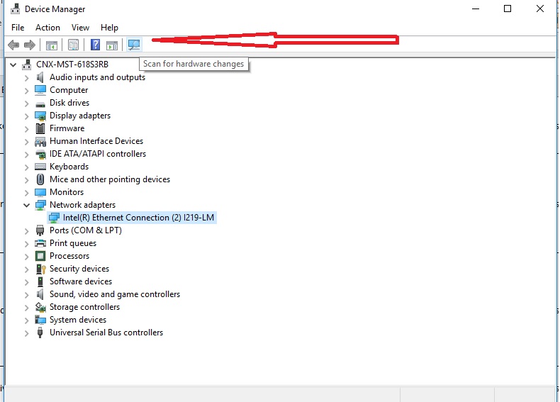

    Since you've installed the Windows 10 Creators update, you should also update the WiFi adapter to resolve the issue. You may check for the latest driver of your WiFi adapter through Device Manager. To do so, please follow the steps below:
    • Press Windows key + X, then select Device Manager.
    • Under Device Manager, double-click Network adapters.
    • Right-click on your wireless adapter, then click Properties.
    • Under Properties, click Driver tab.
    • Click Uninstall.
    • Once you're done, click OK.
    • Left-click on the wireless adapter to highlight it.
    • Click Scan for hardware changes to search for the most updated driver for the device.
    Can't connect to WiFi, driver missing even after installing new one from Intel 2a85f1ca-5ead-4542-b6a7-881f9ea2fd0f.jpg
    Feel free to post back with the result for further assistance.
