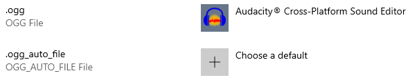

    .ogg files are associated with Audacity. I've tried completely uninstalling it, but that also didn't make a difference. I just looked at Default Applications and .ogg isn't listed in there at all, though, oddly. Could that be related? .ogx files are associated with "Films & TV". On a hunch, I tried associating .ogg with another program (Foobar2000) and back to Audacity. The problem was still there both while they were associated with Foobar and when I associated them back with Audacity, but something slightly odd happened in the "default apps by file type" menu - .ogg appeared in there as it's supposed to be, but another one also appeared in there called ".ogg_auto_file", which isn't associated with anything. I can't find any information about this anywhere.

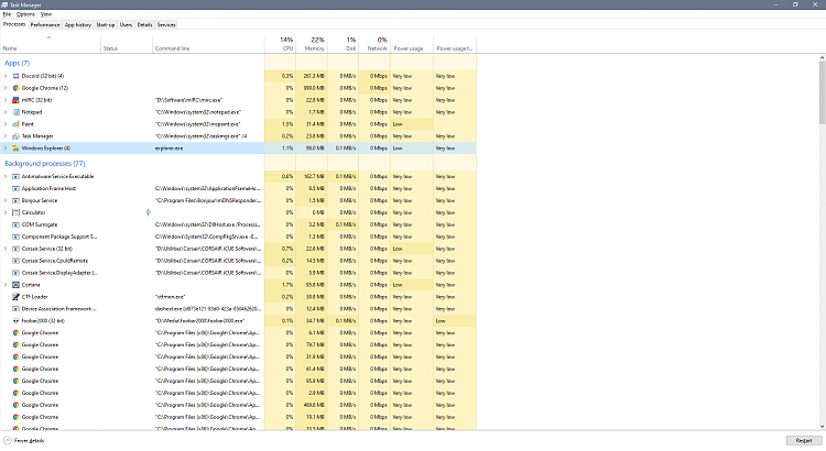

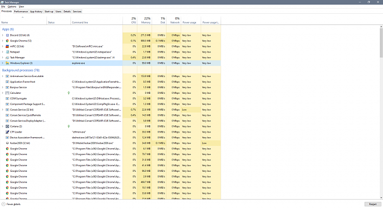

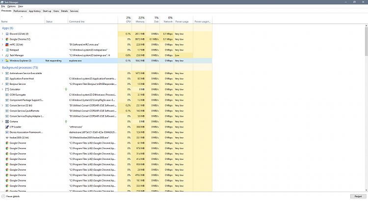

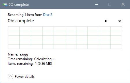

    I've attached a few images - a screenshot each of Task Manager while renaming a file (note the "not responding"), changing the name back after renaming it (it didn't change to "not responding", but the "renaming" dialogue was present but not doing anything - "Time remaining" just said "calculating" the whole time), and one of Explorer as it normally is. I didn't notice any difference in any of the CPU/memory/disk/etc. columns. There's also one of the renaming dialogue from when I was undoing the rename of a file that I was testing it with, and the ".ogg_auto_file" thing that appeared in Default Apps.
