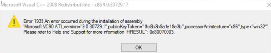

    Hello, I have downloaded VC++ redist installation from the following web page: https://www.microsoft.com/en-US/down....aspx?id=26368 Actually I'm trying to install a software that can be installed on windows host without any problems. The host version is the same "Version 10.0.19045 Build 19045". The software installation fails with the same message I already posted above. So the next step I tried was to download and install VC++2008 separately, but that finished with the same error. I want to emphasize that I'm able to install this software on the host without any problems.
    Cant download the x86 2022 version of VC Redist 396319d1693285990t-error-installing-vc-redist-windows-10-sandbox-setupfails.png
    The only difference in the messages i see is process architecture x64 vs x86, but sure whether that's relevant.
