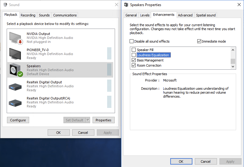

    Loudness Equalisation is in the Properties of each specific capable output device in the Sound control panel...
    You may need to switch it off for all your potential output types.
    I would also disable bass management if you have no separate sub for that device.
