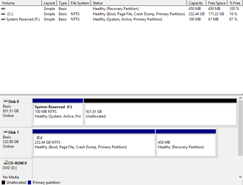

    Moving System Reserved partition to a different drive | [image]
    I currently have one drive that contains a System Reserved partition (which includes the boot files). The status is System, Active, Primary Partition.
    I have another drive with the C: partition. The status is Boot, Page File, Active, Crash Dump, Primary Partition.
    I've been told that if I remove the disk (it's a bit flaky) with the System Reserved partition, I won't be able to boot up. If this is true, is it possible to transfer that partition to another drive? If so, does it have to be at the start of the drive?
    Alternatively, can I make the C: partition include System status?
    Can't Fix Wrong Active Drive - Boot drive on different disk than system reserved... 8ndHKzI.png
    MikeC07, Aug 27, 2023
