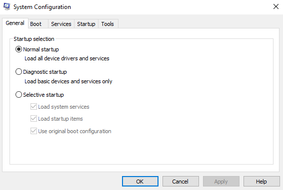

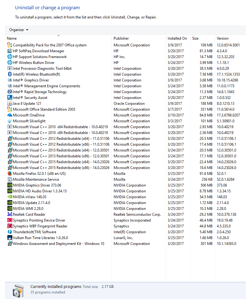

  4. Can’t get computer to start normally with msconfig
    how to troubleshoot msconfig not allowing normal start up
    Yesterday the Microsoftanswers web site was malfunctioning. Today it is working.
    For the inability to start in normal boot on the clean install I was looking for a more efficient way to determine which if any item installed (software or hardware could be interfering with the normal boot.
    The sfc scannow and dism restorehealth did not find any problems
    The UEFI disgnostics reported that the loop until failure tests all passed.
    There were only 39 items listed in control panel as per the earlier post.
    All of the drivers/appplications listed for this computer make/model were reinstalled from the HP web site.
    There was nothing standing out in the msinfo32 or eventvwr that I could interpret as related to the inability to make a normal start up.
    The plan was to uninstall items one by one and check each boot unless I could find a better method.
    Today I started the first item uninstall and it displayed that I had to reboot for uninstall or press no. I ended up doing 4 items, and then rebooted. Upon reboot after uninstalling 4 items the msconfig start up displayed normal start up.
    Can’t get computer to start normally with msconfig 3e851d54-773f-403c-90ac-3241077ad492.png
    This is the msconfig now with 35 items. Now one of the prior 4 item was producing the selective start up.
    Can’t get computer to start normally with msconfig 9ff8dc2a-5084-4c7e-b341-4de87eafd4cd.png
    Now I plan to reinstall the items one by one if I can find them and see if it can be determined which one was interfering with the normal start up.
    questions_, May 6, 2024
