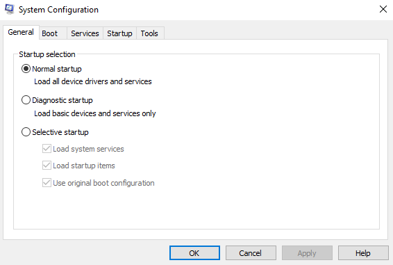

    Today I started the first item uninstall and it displayed that I had to reboot for uninstall or press no. I ended up doing 4 items, and then rebooted. Upon reboot after uninstalling 4 items the msconfig start up displayed normal start up.
    Can’t get computer to start normally with msconfig 3e851d54-773f-403c-90ac-3241077ad492.png
    This is the msconfig now with 35 items. Now one of the prior 4 item was producing the selective start up.

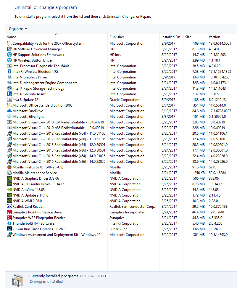

    Can’t get computer to start normally with msconfig 9ff8dc2a-5084-4c7e-b341-4de87eafd4cd.png
    Now I plan to reinstall the items one by one if I can find them and see if it can be determined which one was interfering with the normal start up.
