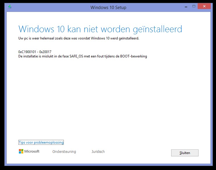

    Hello everyone,
    I have a Samsung laptop with Windows 8.1 installed, and I wanted to upgrade to Windows 10.
    When I tried a clean install with USB the loading animation didn't show under the windows logo, even after a few hours.
    The same issue for the normal "upgrade" option.
    So then I turned it off and back on with this error:
    Can't install Windows 10 on Samsung NP-RV511 (Broadcom WiFi card issue) 03213daf-28d8-44e4-a41d-673bbd3e80ab?upload=true.jpg
    So I googled this problem and I saw a few topics with the exact same problem:
    https://answers.microsoft.com/en-us...-samsung/8ea46dea-b77f-42f7-b22f-6fcdfe080b26
    https://answers.microsoft.com/en-us...problems/3b207475-69af-478b-83bf-667cca21cec3
    Things like updating drivers, DISM cleanup-image etc. does not work
    The problem is the WiFi network card (Broadcom), as when the Broadcom WiFi is removed, the loading circle under the windows logo shows up and will continue the installation of Windows 10:
    https://www.youtube.com/watch?v=Q0cKGAm3jDs
    https://www.youtube.com/watch?v=cUfdqHJIei4
    That's a way to install Windows 10, but then you won't have WiFi.
    Because when you turn the Broadcom WiFi card back in, the loading circles won't show.
    Also the Media Creation Tool says all hardware is fine for Windows 10.
    My samsung laptop: Samsung NP-RV511
    Is there any other solution than replacing my Broadcom WiFi card?
    Can this issue be fixed by Microsoft and/or Samsung?
    Thanks!
    - Dennis

  4. Can't install Windows 10 on Samsung NP-RV511 (Broadcom WiFi card issue)
    Samsung RV511 upgrade problems to windows 10
    Dear Anju
    Thank you for your reply. There are a large number of posts and it is very well documented that clearly identify this very issue and no amount of going back to basics and doing the same thing over and over with the same result will solve this problem.
    As we know the problem is with the Broadcom WLAN card in the Samsung RV511 and the only way to resolve the issue to date is to change this wifi card.
    Can you please tell me and the Community of Samsung Owners
    -Are Microsoft intending to send any update with regard to this Broadcom Wi Fi card issue?
    -Or do we need to have the Wifi card changed?
    Thank You
    IanAndrews7, Jun 25, 2019
