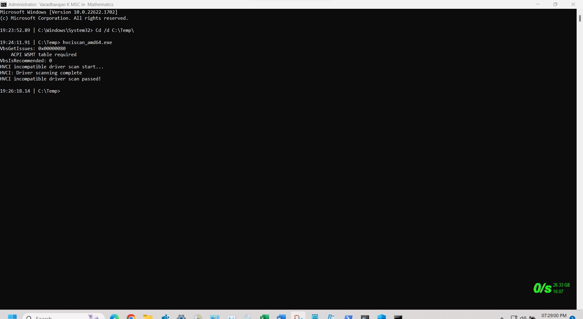

    To find the drivers incompatible with HVCI
    Open Command Prompt application with administrator rights
    type below line
    Cd /d C:\Temp\
    hvciscan_amd64.exe
    Can't turn on HVCI even though no incompatible drivers show up. Thgnz4I6%2fkbVErrfwMMklNH%2blHKxiYhztifyLJwiFq5lxPeMMUfGnDsd6X%2fGEBMmpPnkZbnypW6I8RE6Q5G4TUU%3d.jpg
    Wait for a few minutes to complete scanning and it will list incompatible drivers
    Result is displayed
    VbsGetIssues: 0x00000080
    ACPI WSMT table required
    VbsIsRecommended: 0
    HVCI incompatible driver scan start...
    HVCI: Driver scanning complete
    HVCI incompatible driver scan passed!
    The above result shows No incompatible drivers or Memory integrity already enabled.

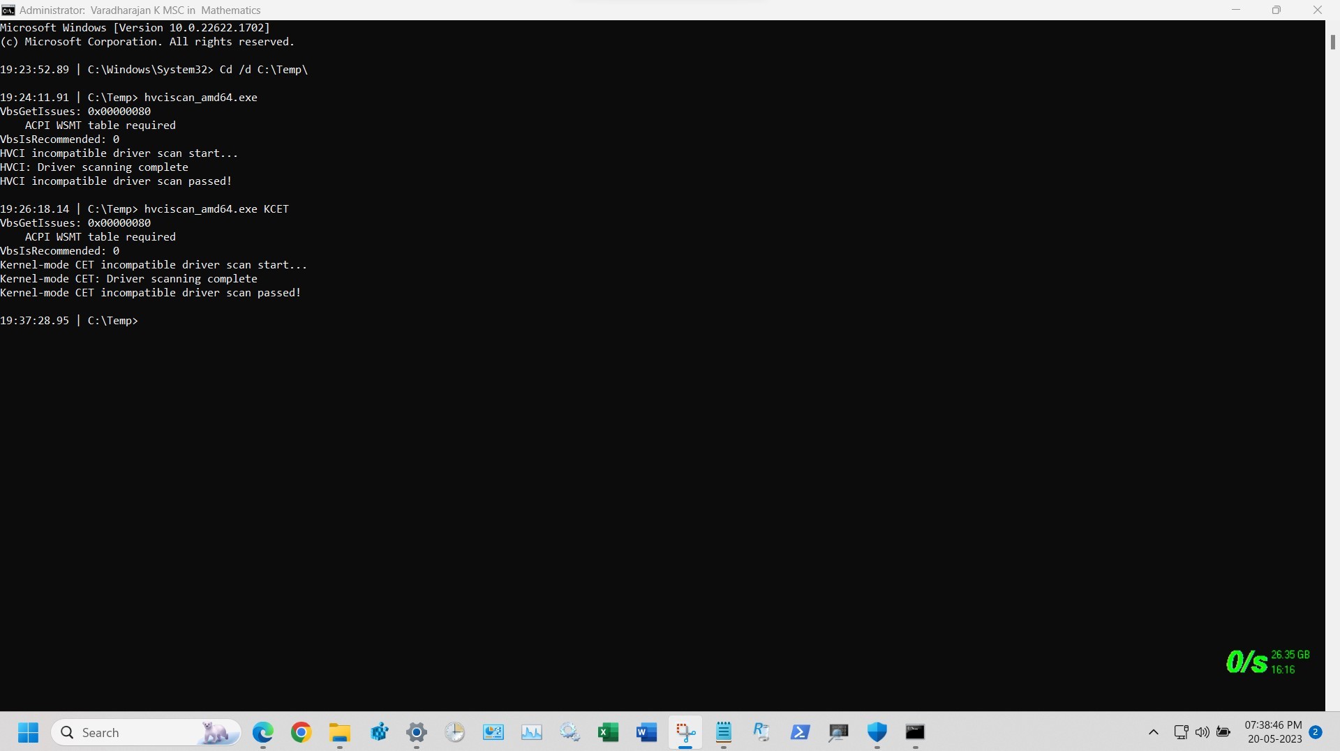

    Another command to detect drivers incompatible with kernel-mode CET
    type below line
    hvciscan_amd64.exe KCET
    Can't turn on HVCI even though no incompatible drivers show up. VFvXoEKC0Su3SFGlrK6l7k0CwYhnHdU3G9t4bkppmpmJb6Aq4BHzn%2fS3gzgxcByVJ9RXy3w3tswuNqfiiQ8Z7fXw3c8%3d.jpg
    Wait for a few minutes to complete scanning and it will list incompatible drivers.
    Result is displayed
    VbsIsRecommended: 0
    Kernel-mode CET incompatible driver scan start...
    Kernel-mode CET: Driver scanning complete
    Kernel-mode CET incompatible driver scan passed!
    The above result shows No incompatible drivers or Kernel-mode Hardware-enforced Stack Protection already enabled
