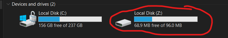

    How to remove the partition created in EFI volume while removing Grub in windows 10
    Good day guys,
    I happen to follow the following process to remove GRUB:
    1. Run a cmd.exe process with administrator privileges
    2. Run diskpart
    3. Type: list disk then sel disk X where X is the drive your boot files reside on
    4. Type list vol to see all partitions (volumes) on the disk
    5. Select the EFI volume by typing: sel vol Y where Y is the SYSTEM volume (this is almost always the EFI partition)
    6. For convenience, assign a drive letter by typing: assign letter=Z: where Z is a free (unused) drive letter
    7. Type exit to leave disk part
    8. While still in the cmd prompt, type: Z: and hit enter, where Z was the drive letter you just created.
    9. Type dir to list directories on this mounted EFI partition
    10. If you are in the right place, you should see a directory called EFI
    11. Type cd EFI and then dir to list the child directories inside EFI
    12. Type rmdir /S ubuntu to delete the ubuntu boot directory
    But now am left with the disk Z: partition after GRUB was successfully removed.
    Change EFI directory disk 04127b34-8f52-4fbf-b2f5-03442322a885?upload=true.png
    Is there anyway i can fix this without affecting the normal booting of my computer ?
    Faithfully
    Ian
    ian shaloom, Dec 8, 2024
