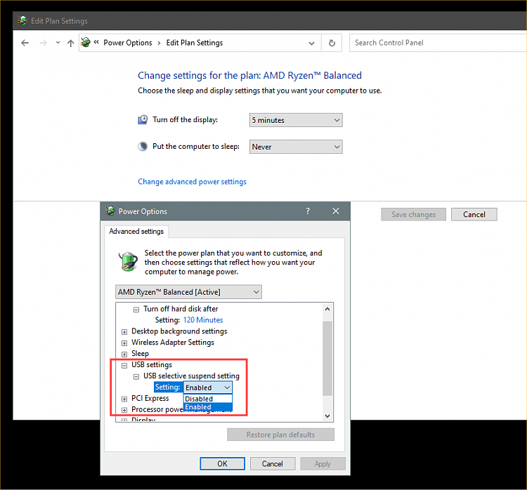

  4. Ghot Win User
    Change purpose of rear audio port
    Lenovo P620 rear audio port audio cut outs
    Go to Settings > System > Power and Sleep > Advanced power settings > Change plan settings > Change advanced power settings...
    Change purpose of rear audio port 345628d1631160223t-lenovo-p620-rear-audio-port-audio-cut-outs-image1.png
