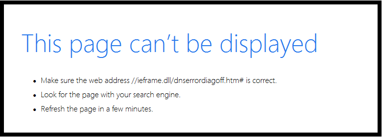

  4. chm file shows script error , when opening through function call HtmlHelpW .
    CHM not opening from network folder
    I can't find anything answer to my problem:
    One user complained that he could not open CHM file.
    Error:
    chm file shows script error , when opening through function call HtmlHelpW . 97ebb69d-0345-4621-b90a-c7f30c19c782?upload=true.png
    He mentioned, after vacation everything worked.
    What I found:
    .chm not opening from network folder, after copy this file on desktop, problem solved. But the person is working with much .chm document, and copy all uncomfortable.
    What I tried:
    • Change HKEY_LOCAL_MACHINE\SOFTWARE\Microsoft\HTMLHelp\1.x\ItssRestrictions MaxAllowedZone to 1;2;3;4
    • Create UrlAllowList in regedit.
    • Uninstall last installed windows updates.
    • Open from another (administrator) user on this pc.
    • Change location of .chm file f:\ g:\ and other mapped disk, or open path with ip: \\192.168.1.1\folder\file.chm
    • No "#" or "%" symbol in file name or path.
    • No choose "unblock" in properties.
    • Other computers with same windows from image, can open this file from network folder.
    Maybe you have more ideas? Thanks.
