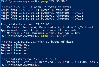

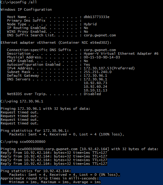

    Dear team,
    I recently installed docker on a machine running on Windows Server 2016 by following this guide:
    Prepare Windows operating system containers
    After successfully installing docker, I proceeded with the next guide to run my first container:
    Run your first Windows container
    Every step in this guide also worked, with the exception that I used this image "mcr.microsoft.com/windows/servercore:1607" instead of the nanoserver suggested, because my machine runs on the version 1607 - OS build 14393.3808, and seems like I needed an image
    supported my OS version.
    Anyway, I'm able to pull images, run the container and work with it.
    The problem arises with networking, because it seems like my server (which is also the host for docker) can't reach the container's address.
    I was told that if everything works properly, I should be able to:
    - ping container's Default Gateway from the host (works)
    - ping container's IP Address from the host (doesn't work)
    - ping host's IP Address from inside the container (works)
    - ping container's Default Gateway from inside the container (doesn't work)
    The screenshots below will show you the results mentioned above.
    Commands run inside the container:
    Chrome experiences significant delays when launching within a Windows Docker container. a1d0e69a-ddcf-4b96-ad75-d089d1440ab7?upload=true.png
    Commands run from the host (scw000100860):
    Chrome experiences significant delays when launching within a Windows Docker container. bbfeebe0-c759-4b67-99eb-4fed06f9bb05?upload=true.png
    I have already set the NetIPInterface so that the interface that accesses internet has the lowest InterfaceMetric value.
    Chrome experiences significant delays when launching within a Windows Docker container. c43361a0-9115-4622-af29-9b3f89059a50?upload=true.png
    These were the things I was told from the software provider that my company needs to install. The software runs multiple containers but seems like they're not reachable so the tool obviously won't work, but they told me the issue is on docker side, since
    I'm not able to ping any container's IP Address from the host.
    Please let me know what I can do to fix this issue or if I can provide more information to you.
    Thanks a lot in advance.
    Nicolò
    Nicolo Santini (external), Apr 18, 2024
