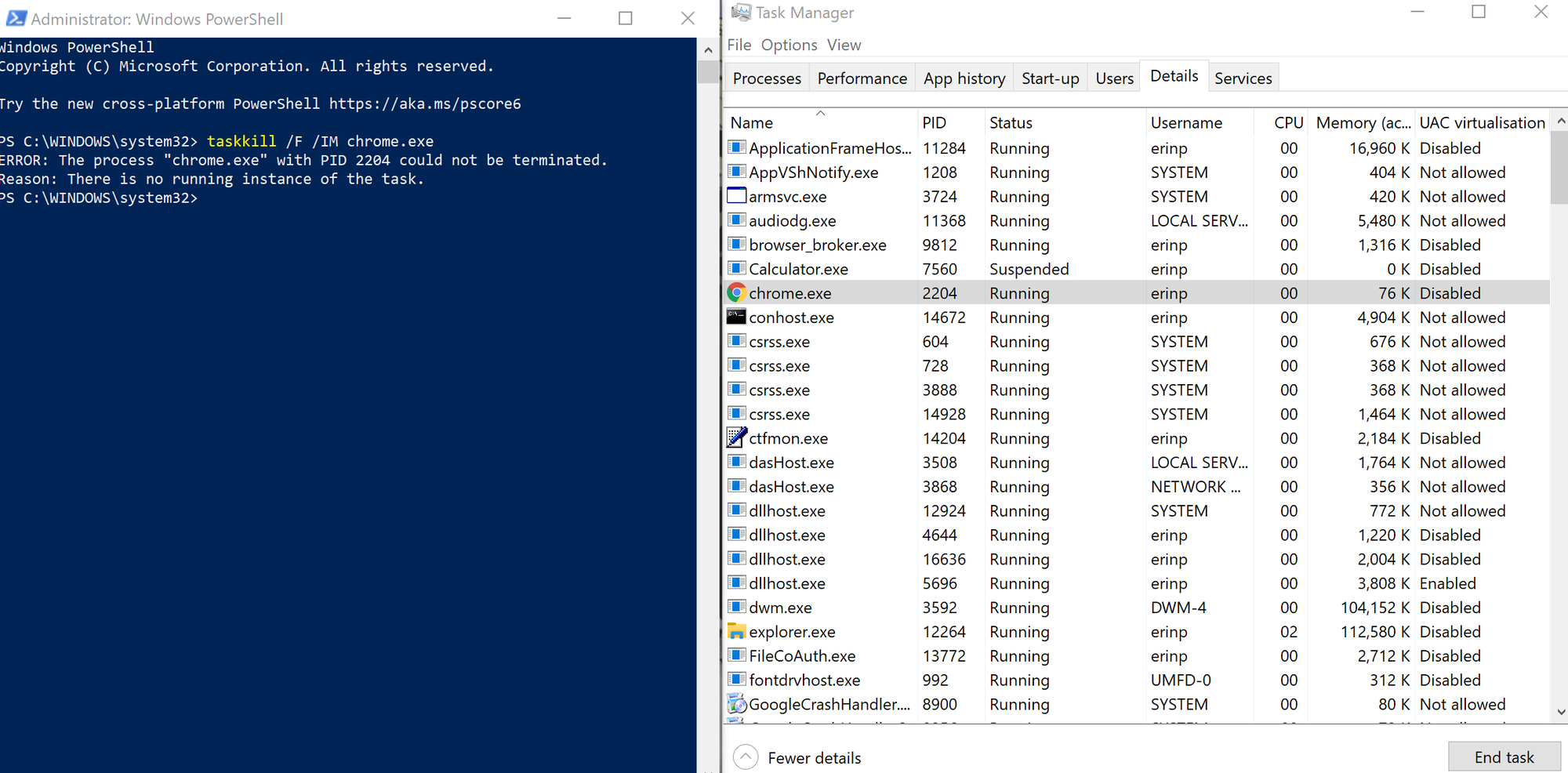

    I can't get Chrome to open. When I click on it, something loads for a second then nothing. I tried ending the process, but it says access denied chrome.exe in screenshot.
    I also tried a taskkill prompt with the Windows PowerShell Admin Windows 10 which is what was recommended on another thread where someone had the same problem. When I try to uninstall the app it says it cannot be done because windows are still open. I also did a full threat scan.

    Since you already uninstalled Google Chrome using the Programs and Features, Google notifications may still be running in the background processes. We suggest that you follow these steps on how to end the Google Chrome process:
    • On your keyboard, press Ctrl+Alt+Delete.
    • Select Task Manager.
    • Under Processes, locate Google Notifications or Google Chrome.
    • Right click on them and select End Task.
    • Double check under Programs and Features if Google Chrome is completely gone.
    Let us know if these steps worked.

    Hello! I am an Independent Advisor, I would love to help you out!
    Are you getting any error messages when it tries to open?
    The first thing I would try is to restart your computer and then test it.
    If a restart does not work then I would suggest to open task manager and close any chrome servers.
    To do this you can right click the task bar and select task manager.
    Then click "more details".
    Under the processes tab scroll through everything and look for anything that says chrome or has the chrome icon.
    For anything that is chrome click on it then select "end task".
    After this is done go to the "details" tab and do the same steps.
    After this attempt to open chrome again.
    If neither of these work then you should try to uninstall chrome then re-install it.
