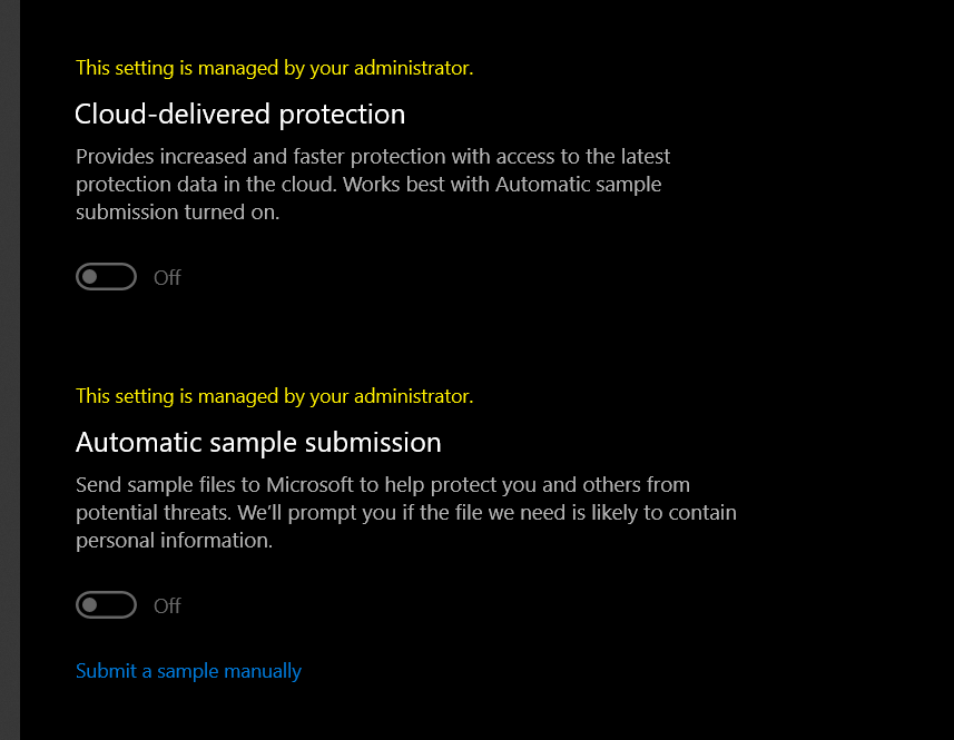

    SOLVED: Cloud-Delivered protection and Automatic sample submission. This setting is managed by your administrator
    Hi, I cannot manage to figure out whats wrong here. In windows defender settings I cannot turn on Cloud-Delivered protection and Automatic sample submission, it says This setting is managed by your administrator. All other options I can turn on and of. imgur.com
    EDIT; I solved it with help from tech support.
    Go to Start > type group-policy > select Local Group Policy Editor Go to Computer Configuration > Administrative Templates > Windows Components > Windows Defender Antivirus > MAPS Disable the following features: Join Microsoft MAPS Send file samples when
    further analysis is required Go to C:\Program Files\Windows Defender Advanced Threat Protection\SenseSampleUploader.exe > Enable Firewall profiles Restart your computer.
    I couldn't get SenseSampleUploader.exe to run. But I did the former steps and restarted the computer. I then got an alert from windows defender telling me these options were off and I could enable/disable at my own digression again. Hope this fixes it for
    someone if they run into the same problem "Cloud-delivered protection" and "Automatic sample submission" are turning on, but there... :)
