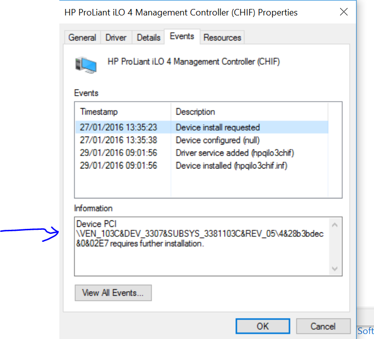

  3. jimbo45 Win User
    The drivers for this device are not installed. (Code 28)
    Hi there
    Go to the EVENTS panel and you should see something like this : (note this is just an example from my system - your's will be different of course).
    Code 28: Driver for this device are not installed. 61361d1485962520t-drivers-device-not-installed-code-28-a-details.png
    Now with the Vendor info you should be able to google for the proper driver - or at least get the hardware vendor ID from which you can go to a website.
    Search on the characters between the \...and \ symbols or even just the first bit until you find a match.
    Cheers
    jimbo
