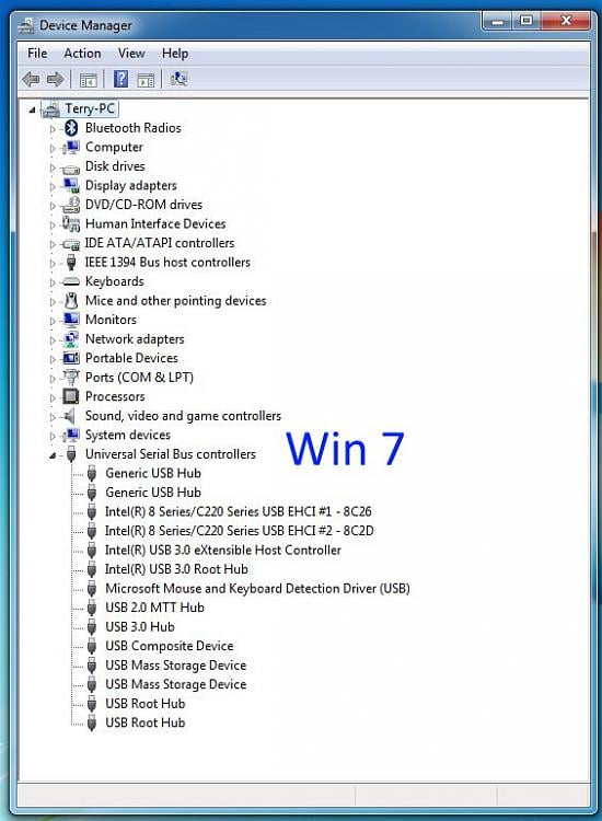

  3. USB SuperSpeed error code 43
    Win 10 ver 1709.
    Device Manager always reports the SuperSpeed has a problem.
    I have tried uninstalling, updating drivers and a Win 10 online reinstall (repair upgrade?). No change. I installed Win 7 to a spare drive and it finds no USB problems. Also, in Dev Mgr, Win 7 does list a SuperSpeed.
    I attached snips of USB Tree and Dev Mgr under Win 10 & Win 7.
    I want to make the SuperSpeed error go away.
    Thanks, everyone,
    Terry
    Code 43 for a usb keyboard. 187395d1525468352t-usb-superspeed-error-code-43-a-dev-mgr-win-7-capture.jpg
    Code 43 for a usb keyboard. 187396d1525468352t-usb-superspeed-error-code-43-a-dev-mgr-win-10-capture.jpg
    Code 43 for a usb keyboard. 187397d1525468352t-usb-superspeed-error-code-43-a-usb-tree-win-7-capture.jpg
    Code 43 for a usb keyboard. 187398d1525468352t-usb-superspeed-error-code-43-a-usb-tree-win-10-capture.jpg
    TGeorge111, Mar 7, 2023
