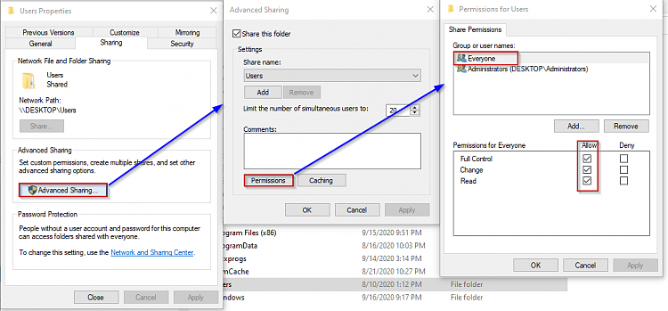

    Pulling my hair out trying to share a folder across my local network
    I share my Users folder as follows:
    Computer has been crashing due to ntkrnlmp.exe and I'm pulling my hair out trying to fix... 297825d1600307271t-pulling-my-hair-out-trying-share-folder-across-my-local-network-image.png
    If Everyone isn't there I add it.
    Computer has been crashing due to ntkrnlmp.exe and I'm pulling my hair out trying to fix... 297826d1600307411t-pulling-my-hair-out-trying-share-folder-across-my-local-network-image.png
    Ztruker, Feb 11, 2024

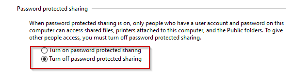

    Thank you! In the permissions portion of the last screenshot, is it possible to set it so "everyone" has just read permission? Or is that configuration grayed out?
    asus2016, Feb 11, 2024
