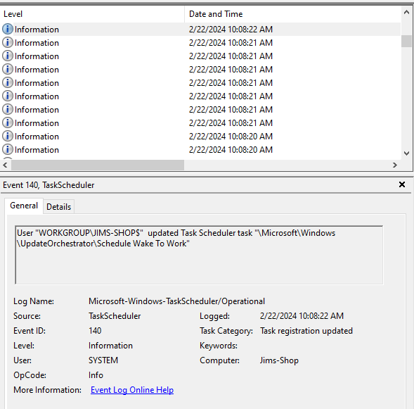

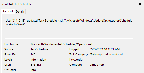

  4. rboppy Win User
    Computer will not wake from sleep via scheduled task
    Task Scheduler to wake from sleep
    Sorry about that, I thought I was sending the results. This is what I got:
    Computer will not wake from sleep via scheduled task 405984d1708630409t-task-scheduler-wake-sleep-info.png
    And every other listed this as the user.
    Computer will not wake from sleep via scheduled task 405986d1708630614t-task-scheduler-wake-sleep-other.png
    rboppy, Dec 21, 2024
